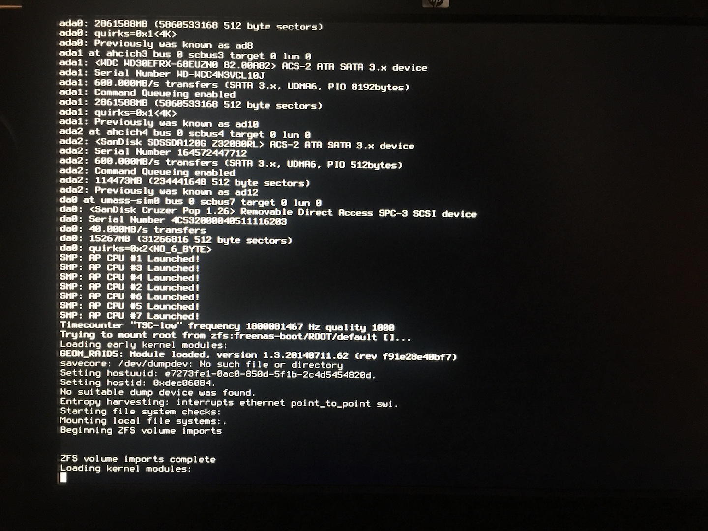

Hey all, I am new to FreeNAS and having an issue loading 9.3 or 9.10. I can however load 10 beta 2.,, I am using the 2 USB method the same way for all 3 but if I try to install 9.3 or 9.10 they both stop on install.
I get an error saying that there is "No suitable dump device". I thought it was an issue with the USB and being corrupt or something but then tried it with 10 beta 2 and it installed flawlessly. I was able to setup volumes, permissions everything was working but if I can't do Plex on 10 then it defeats the purpose.

Can you show us the complete screen output you see when you get the "no suitable dump device" error?

I attached a photo of it.
My processor is the i7-7700 LGA1151
My Motherboard is ASUS Prime H270M-PLUS
I don't think the "no suitable dump device" message is a fatal error. Are you saying you weren't able to install FreeNAS 9.x at all?

Yes it stalls on this part. I let it sit for an entire night and it just stays here. I was able to get 10 beta 2 to install but I couldn't get either 9.3 or 9.10.2-U1 to get past this point.

Hmmm... your screenshot shows "GEOM_RAID5: Module loaded, version..."
Have you configured your disks into a RAID5 array in some way? Or were these disks formerly used in a RAID5 array? If the disks aren't clean, you may need to wipe them with gpart or some such.
But I'm really suspicious that I see RAID5 here where it shouldn't be. FreeNAS doesn't use RAID5, and shouldn't be used with a RAID controller. These are plugged into the mobo's SATA ports, correct?

Ohhhh I think I may know what happened. I think the BIOS had a setting for Raid enabled. I will disable when I get home and try again.

Well, I'm not sure what is going on. I just bought 2 SanDisk 32GB USB drives and tried this again with 9.10.2-U1 and it did the same thing. It hangs up right there and won't do anything. I'm confused.

EDIT: Are you using USB 2.0 or USB 3.0 ports or devices? FreeBSD (and therefore FreeNAS) is known to have intermittent problems with USB 3.0.
I thought that was resolved with the switch to 9.10 and the base OS update to 10.3.
I'm wondering if this is a hardware incompatibility issue. The hardware the OP is trying to install on is brand new and as far as I can remember the first Kaby Lake/200 series system someone has tried to install on.
Perhaps so... I was fishin' for an explanation. :smile:
This. I can't find anything to suggest that FreeBSD supports this brand-spankin' new CPU.
