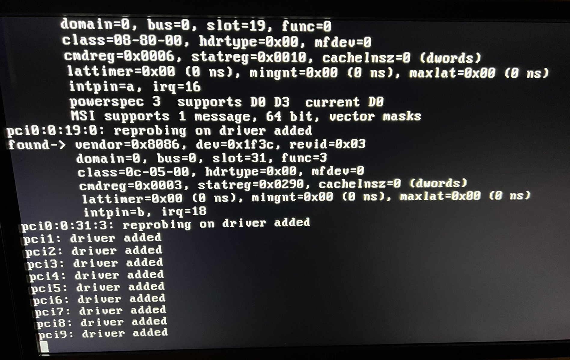

I had 11.3-U8 on a usb drive. I did a manual fresh install (not upgrade) from a 2nd usb drive on the existing 11.3 drive. After reboot, it hangs here (see attached). Any thoughts? It's done this two or three times now, never being able to get to fully boot.
Should I wipe the old 11.3 drive and try again?
Preface, I'm not worried about losing data as I have backups of everything.

Try a different drive for your 2nd install attempt. USB thumb drives aren't recommended any longer, as they corrupt way too easily.

That seemed to be the issue. I completely wiped USB drive and re-installed successfully. Now I'm having an issue importing my pool. I found a similar issue thread stating to use a USB2 device and not a USB3 device, which I am using USB3. I have a PCI-E M.2 adapter coming this week. I'll work on getting a fresh install on that and try importing pool then.
