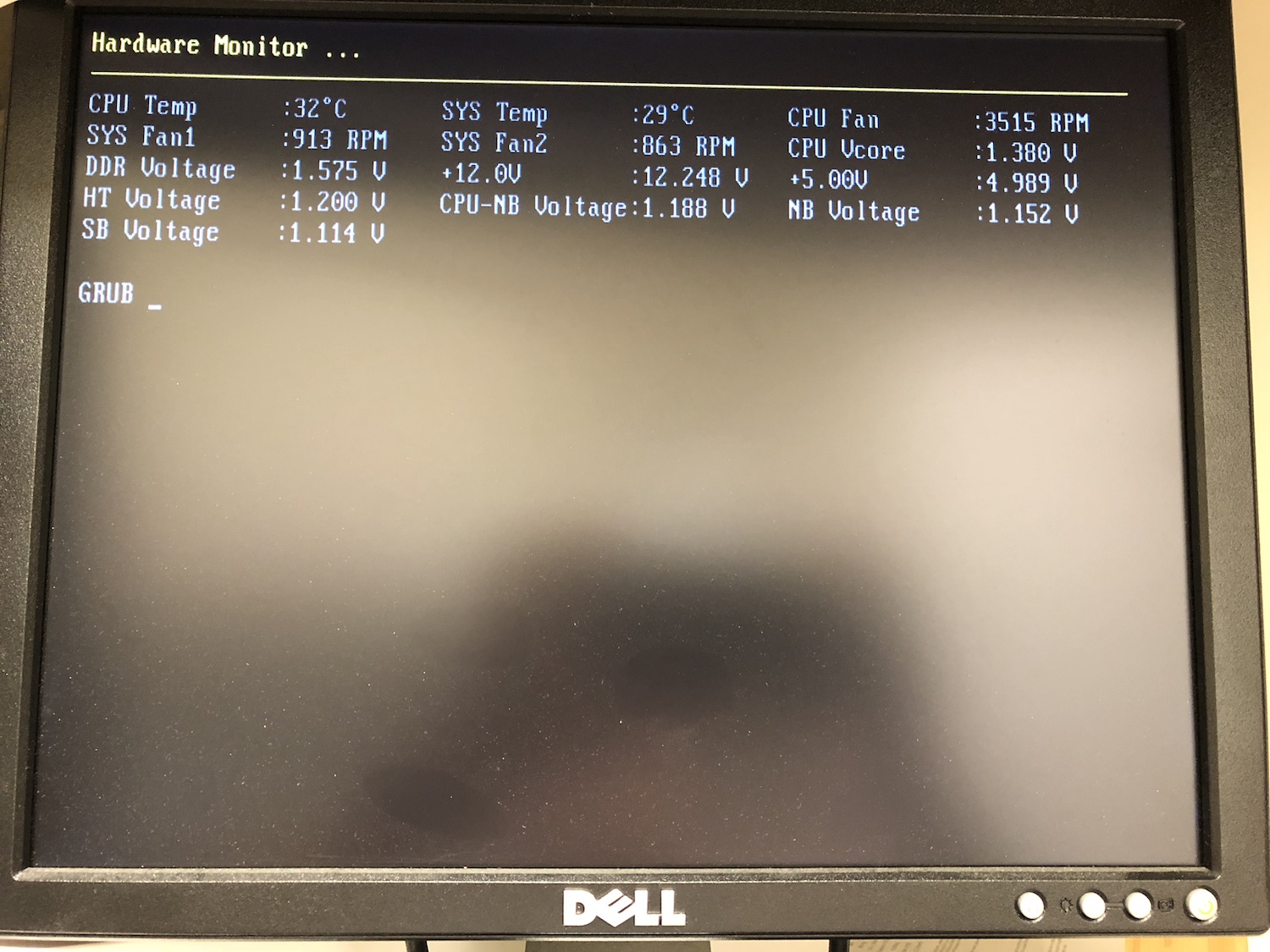

I am running the stable train of FreeNAS 11. FreeNAS became unresponsive from web GUI, rebooted FreeNAS. After reboot, the system is stuck showing "GRUB _" and will not advance any further.

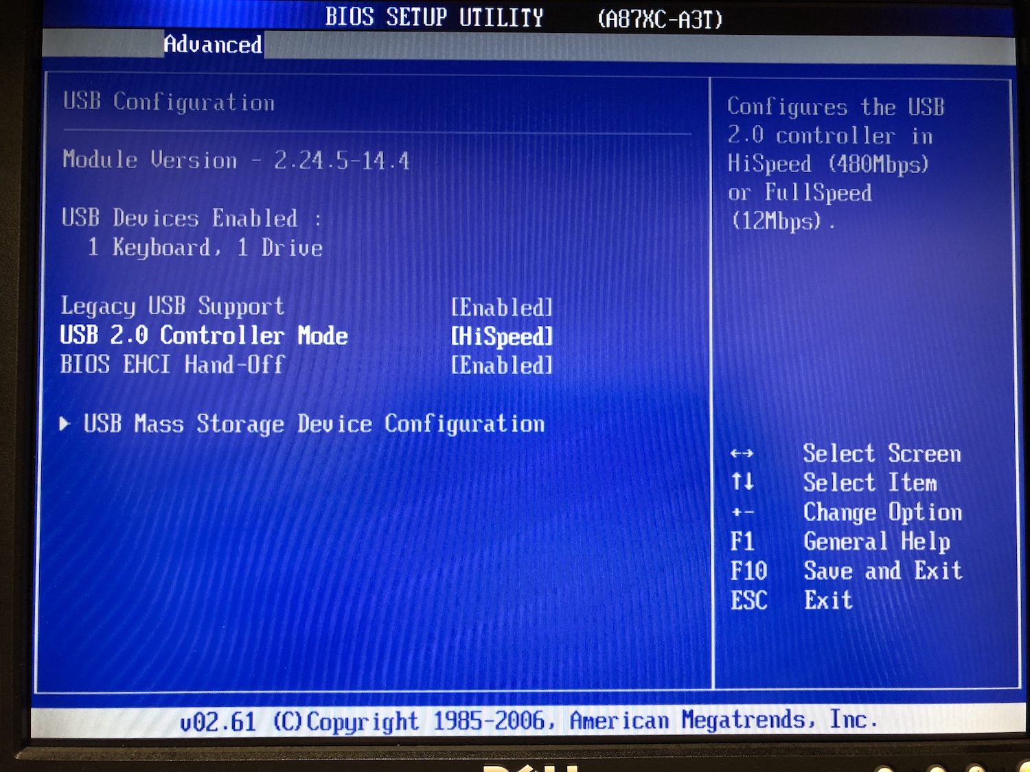

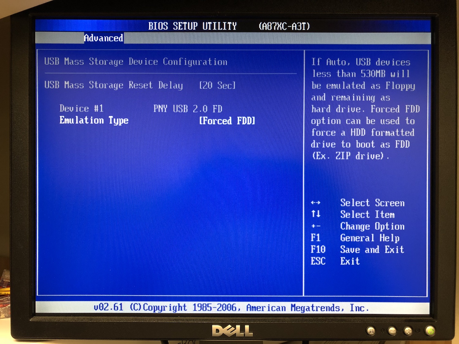

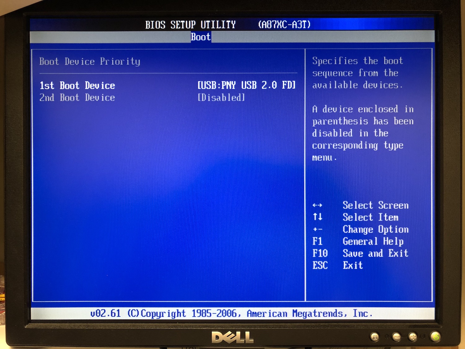

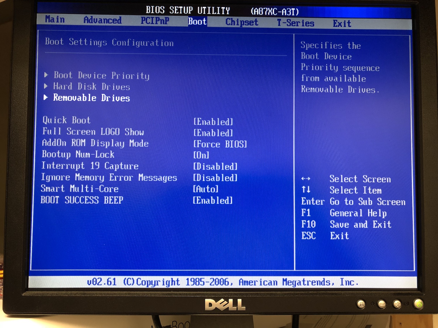

Attached some photos of our system BIOS. This was a working system and I had not changed any settings in BIOS prior to the system getting stuck on boot, only showing "GRUB _"

I don't think you should be forcing the USB drive to emulate a FDD (floppy drive) as that could be part of the problem.
The Asus website lists this board as being Windows 8 ready, so you know it isn't new, and it has audio ports built in, so you know it isn't a server board. I would not be shocked if an older board started to malfunction. It could have a low battery (the coin cell on the system board) and it may have lost a setting. I have seen some odd malfunctions over the years.
The thing I would try first is to have the USB drive as a hard disk (I am not sure what the options are) and try to boot that way. If still not working, keeping the setting at hard disk, try another installation to the USB in that mode and another boot attempt.
By changing to another USB stick, you have somewhat eliminated that as a fault, and if the system ever booted before it should be able to boot again. Unless there is a hardware failure of the system board. You might also check the voltage on the coin cell and if it is low, replace it. This will clear all BIOS (UEFI) settings back to factory, so you will have to reset anything that needs setting, but it may have already gotten scrambled if the voltage was low and that may be the cause of it not booting to start with.

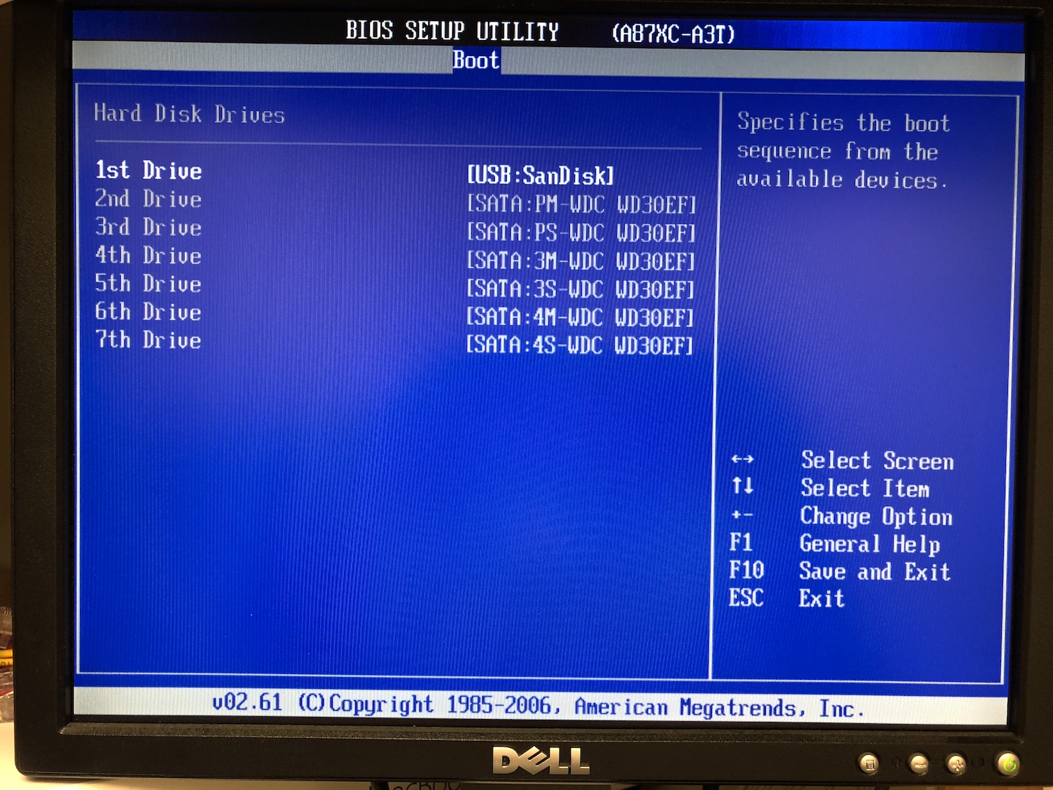

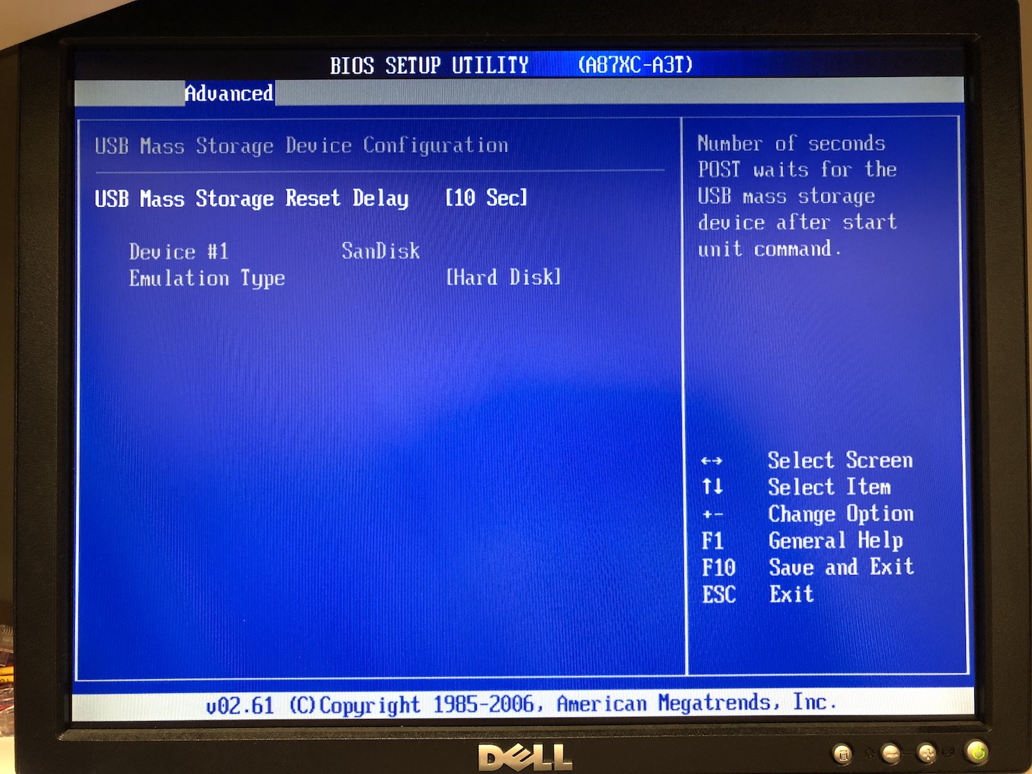

I changed the USB drive to emulate a Hard Drive. I also found a setting in BIOS that allowed me to change the order of the Hard Drives. I moved the new SanDisk USB drive to the top of the list. I was able to get FreeNas to boot. I then restored from a backup config file.
I still believe my initial problems were caused by a failed PYN USB drive. I have had drives fail and replaced them without issue in the past. I believe something changed with BIOS & Freenas when using a new USB drive this time around.
