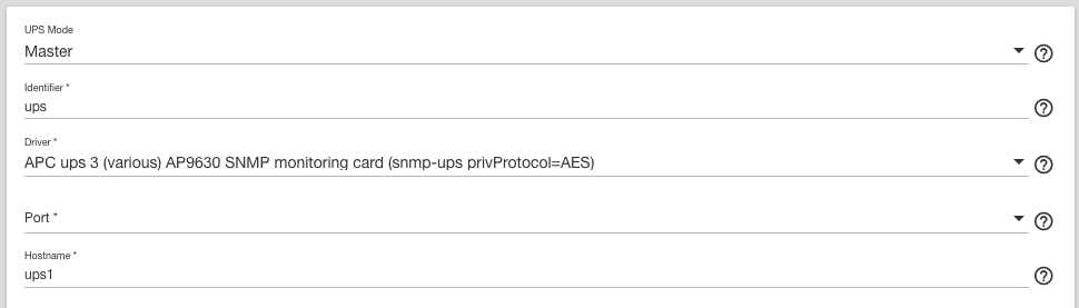

It definitely signals the FreeNAS box that it's on battery--I've never had an outage last long enough to signal a low-battery condition and power down the server, so I can't speak to that from my own experience, but the communication is definitely working. These are my settings; everything else except the notification email address is at default:
My UPS has a hostname on my network of "ups1" (at one point I'd been thinking there would be another UPS which would be ups2, but that didn't actually happen).

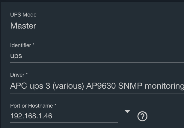

The identifier is, AFAIK, a relatively-arbitrary designator for the unit; I believe "ups" is the default, and I've left mine set there. But it looks like the screen shot I posted up-thread is a little out-of-date; -U4.1 now looks like this:
You can just type in the hostname or IP address in that field.

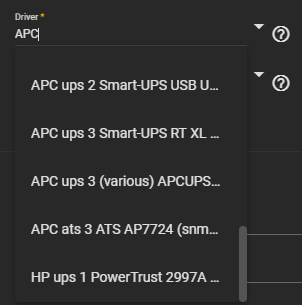

When I click on the driver dropdown, or type in APC, in the list of available drivers I do not see any option for the AP9630 like shown in the images in the prior posts. I will attach an image, but also it seems like putting in an IP address where it asks for hostname or port, it always defaults to localhost, and the UPS is not local, but it seems to ignore the specified IP..

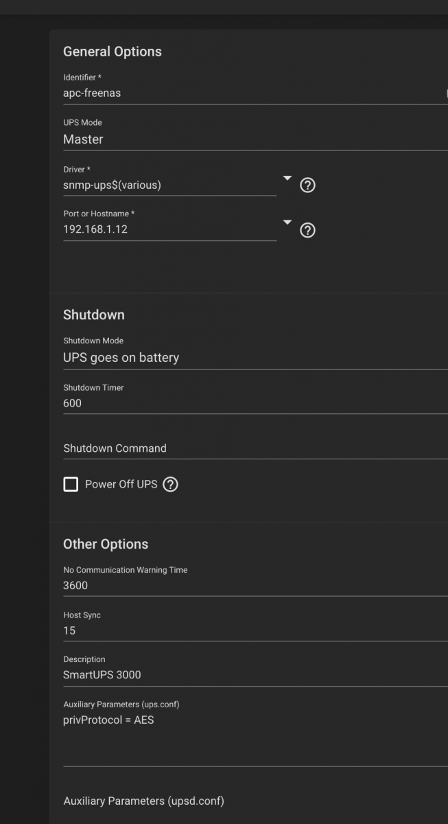

I did end up getting "Various ups 3 (various) SNMP - RFC 1628 (snmp-ups, experimental)" working. I did have to check the "Remote Monitor" checkbox, I think that fixes the listening on localhost issue.
