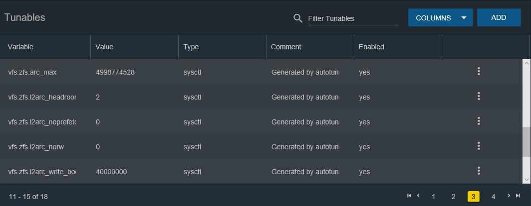

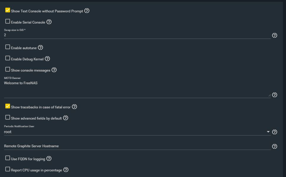

Did you turn on autotune?
It's possible that you have set limits based on 8GB with autotune and it will not change those settings.

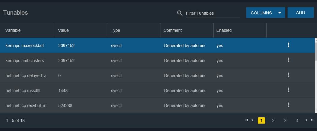

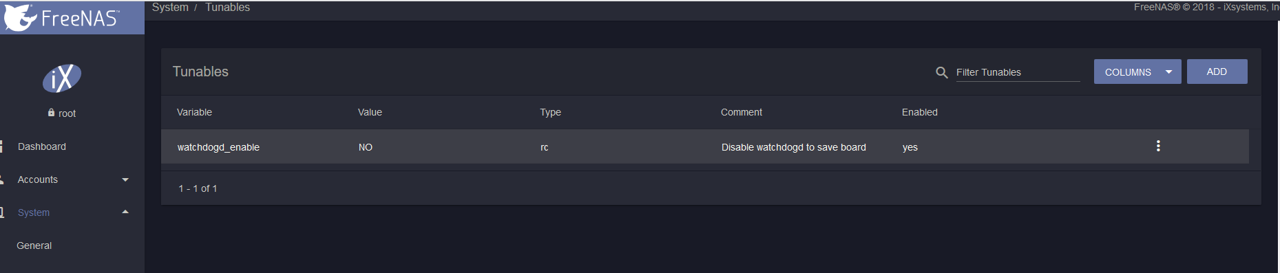

And nothing in System, Tunables?

No - in System, Tunables:

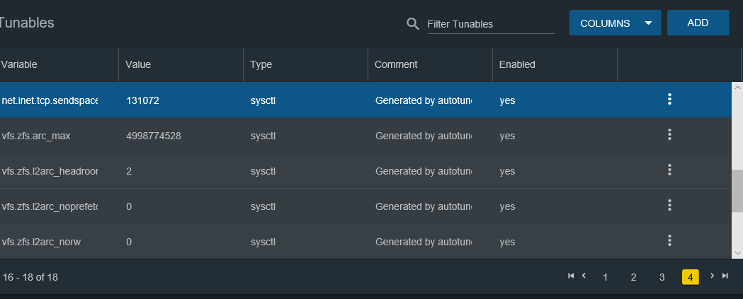

Your ARC is capped at 5GB which is way too low for a 16GB system.

Did you want those tunables? If you don't know what they are delete all of them. Most systems don't have any.
No I didn't want them. I didn't put them in. Yes they are put automatically, can I delete it? Will my problem be solved?
SweetAndLow
Sweet'NASty
Nov 6, 2013
6,421
Yeah delete them, they got put in when you enabled auto tune. You probably shouldn't have done that.
