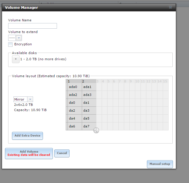

Hey All,
So I'm about to configure this today and I seem to have confused myself...
According to your recommendations, I should be doing 6 vdevs(2 HD's Each)
However, I seem to be confused on how exactly I would set this up. Please see the screenshot below. Is this how I would do it? Or do I need to do 2 drives at a time?
Thank you so much for all your help.
