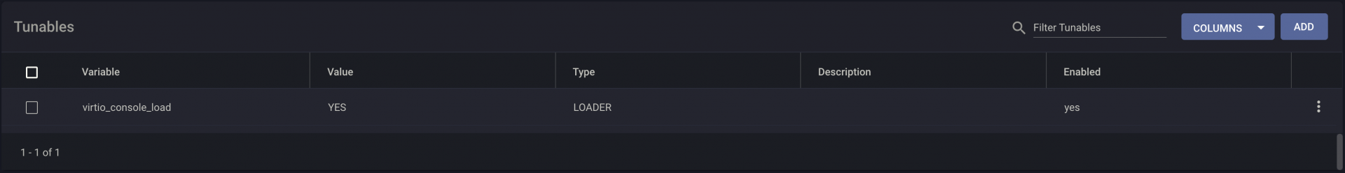

Thanks. I have added the Tunable.

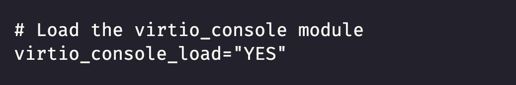

Interestingly, the line I added to the /boot/loader.conf is still present and the system has been restarted since I added it.
Will it have any detrimental effect if I just leave that be? Or should I remove it and let the tunable handle it?

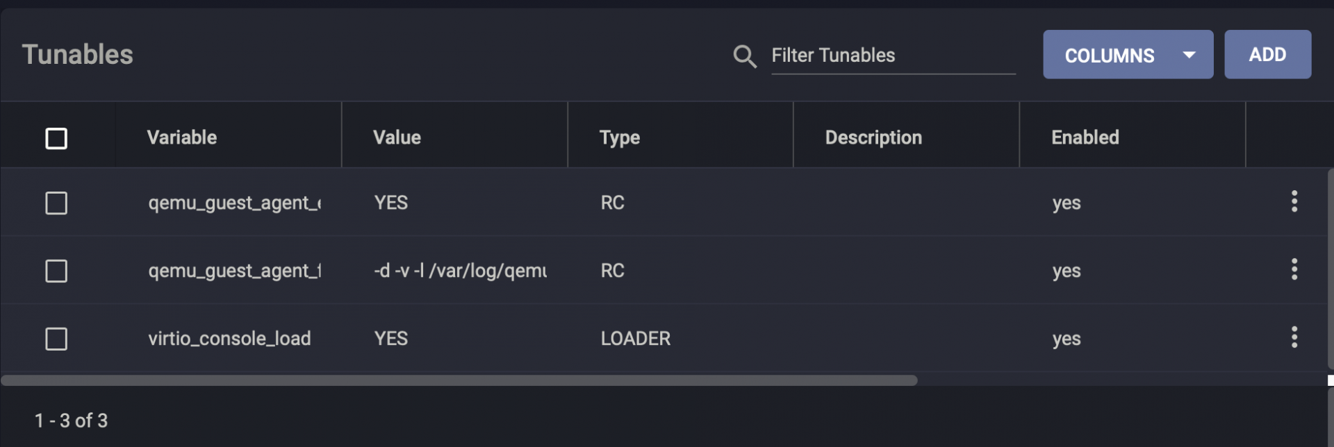

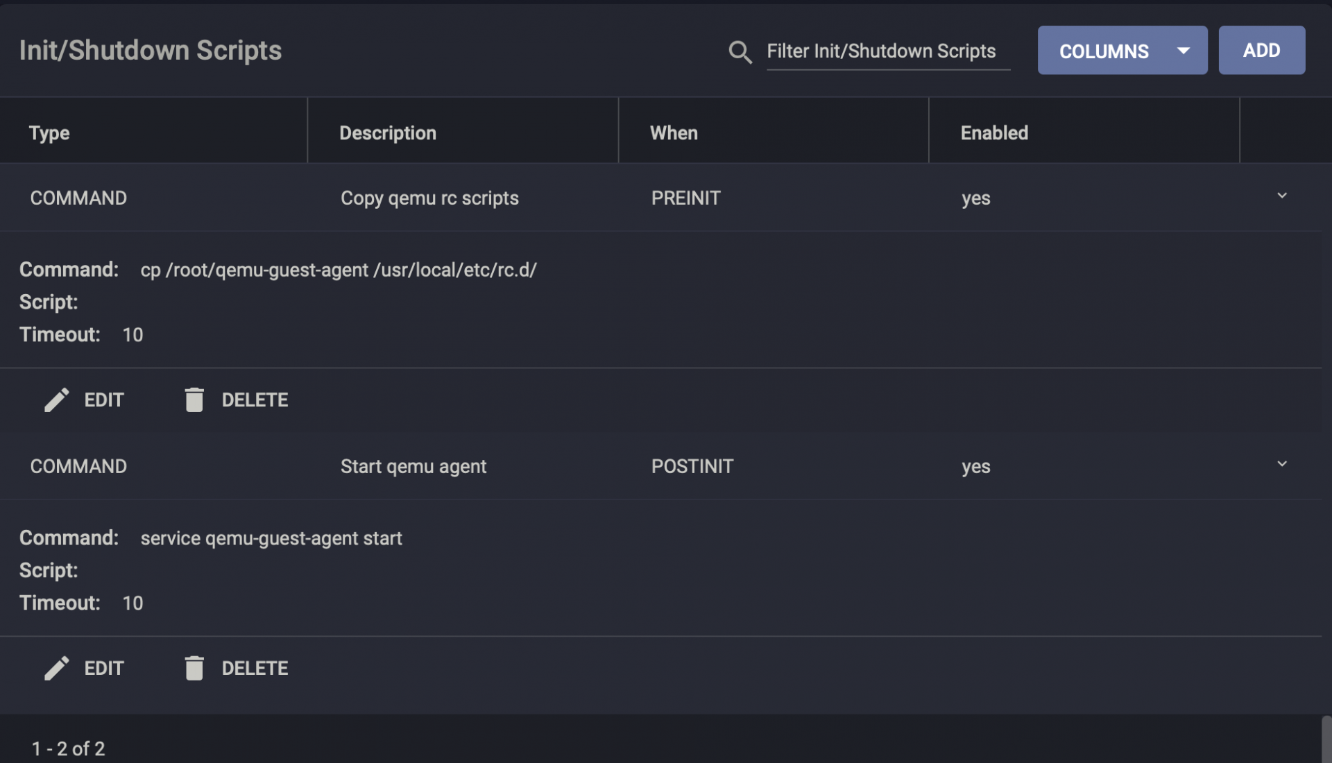

The install is best to be done manually at this point. From your repo look for qemu-ga and put that in /usr/local/bin and then qemu-guest-agent and move that to /usr/local/etc/rc.d/. Here's where I'm not quite familiar with TrueNAS and can't get the service to start automatically even with Tunables entries for rc.conf. I can see the service is enabled but it doesn't get started automatically so I defer to the custom init scripts configuration. I hope someone more knowledgable can chime in and provide a better way (and possible update proof).
Here's my setup so far:
