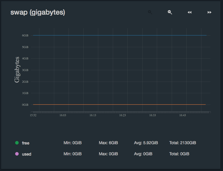

You could be using a lot of SWAP space which is causing the slowdowns. You can check this by looking at your swap report to see how active it is. If you have some jails/plugins running you may want to stop as many as you can to free up some RAM.

I only have one jail running Plex. The only other services that are running are AFP and SSH. The swap report says no swap is currently being used.

Zero swap is of course what we all desire to maintain all the time and so far so good. Keep an eye on the swap space if you notice things are slowing down, I suspect that is going to be your problem assuming Plex isn't using too much CPU horsepower to slow things down.
Well I wish you the best of luck and if it works, I wouldn't change it.
