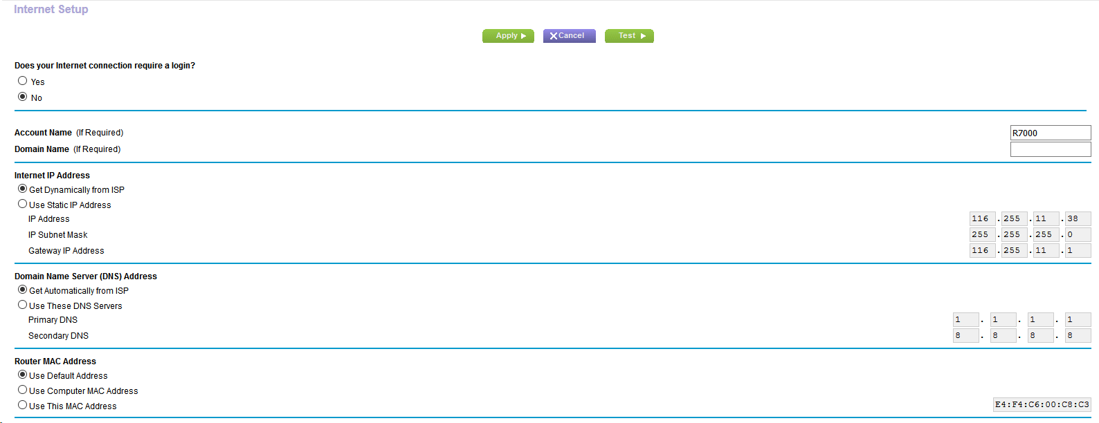

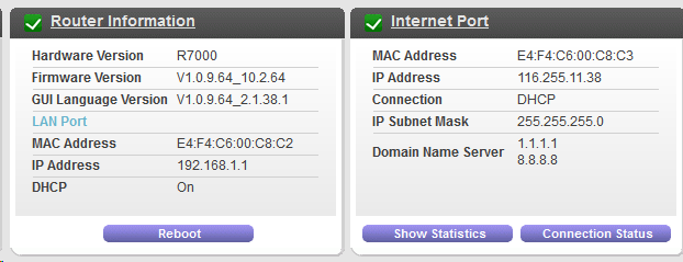

The default gateway listed on the router is now 116.255.11.1

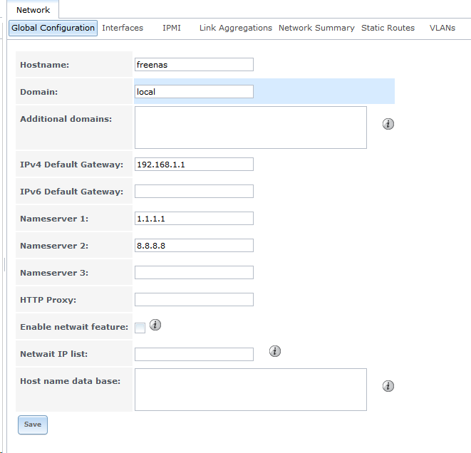

These are global network settings in freenas (i dont know how to change the interface to the new one sorry)

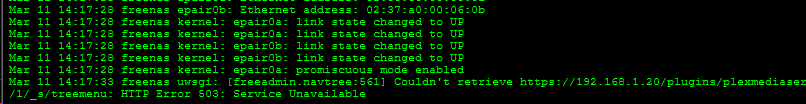

The error i received was from shell when trying to update UMS_Updater.sh from github

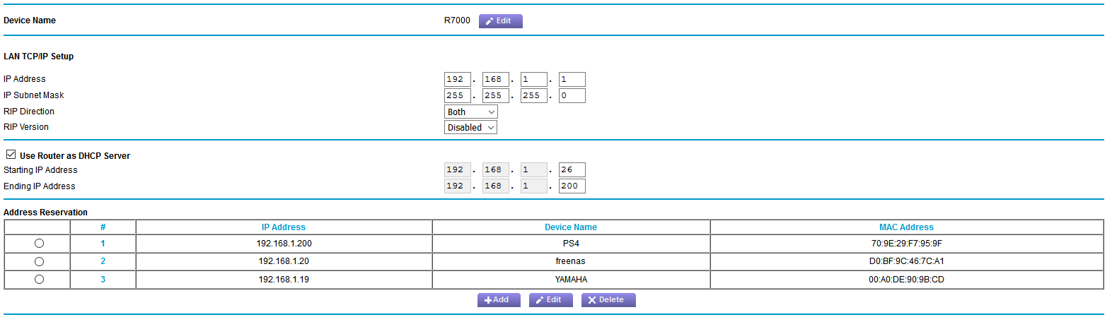

This is the router settings in the LAN TCP/IP page - i think i may need to change these to reflect the new ISP settings, but with everything bar PLEX working, i am loathe to fiddle.

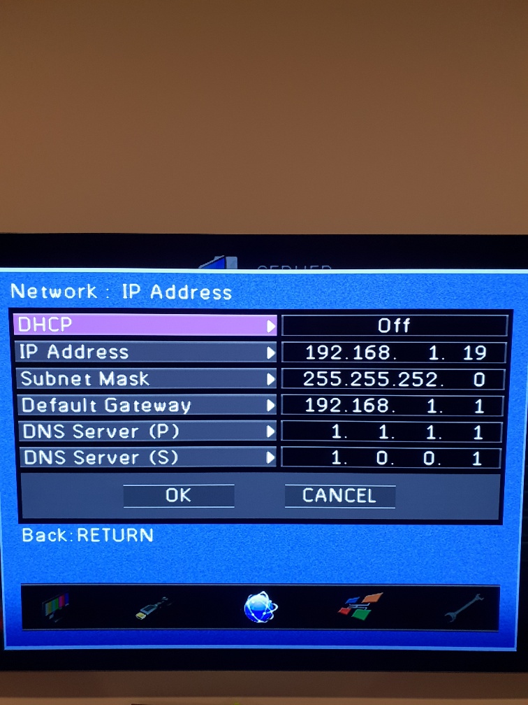

I havent changed these since the new ISP changeover. Below are the Yamaha network settings
I havent changed these on the Yamaha AMP, and the Yamaha app finds and play mp3 from the plexmediaserver_1 Music Jail quite well.

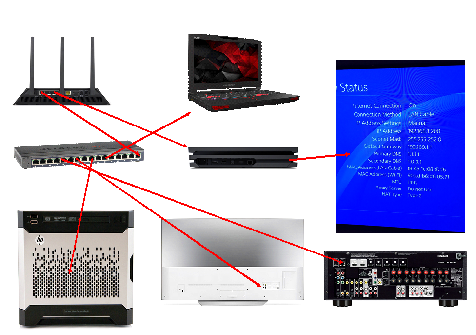

1 Modem
1 Router which connects to my modem
1 FreeNAS machine hard-wired into my router
1 Instance of RancherOS running on this FreeNAS machine
1 Backup FreeNAS machine hard-wired into my router
3 Laptops connected to my router via WIFI
Various phones connected to my router via WIFI
All of my laptops, both FreeNAS machines, and RancherOS have static local IP addresses.

Both the laptop and the LG tv and the Yamaha are LAN connected automatic with no adjustment to settings. The PS4's media server, Yamaha and LGTV can access the PLEX server found on the local network and work just fine.
The browser on the laptop and my phone (remotely) have previously been able to access the server but cant any longer.
Settings for router are as a snapshot
and in more detail

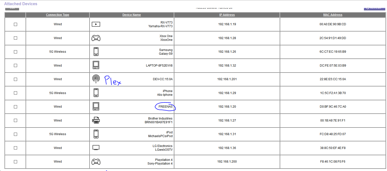

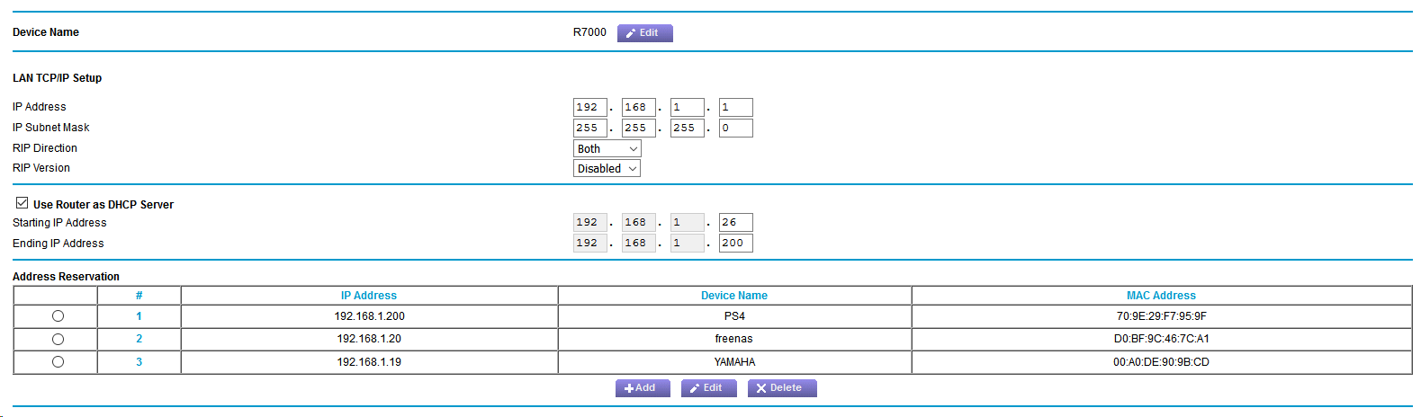

Then the LAN settings page where i have reserved specific address for PS4, Freenas and Yamaha
this is the connected devices

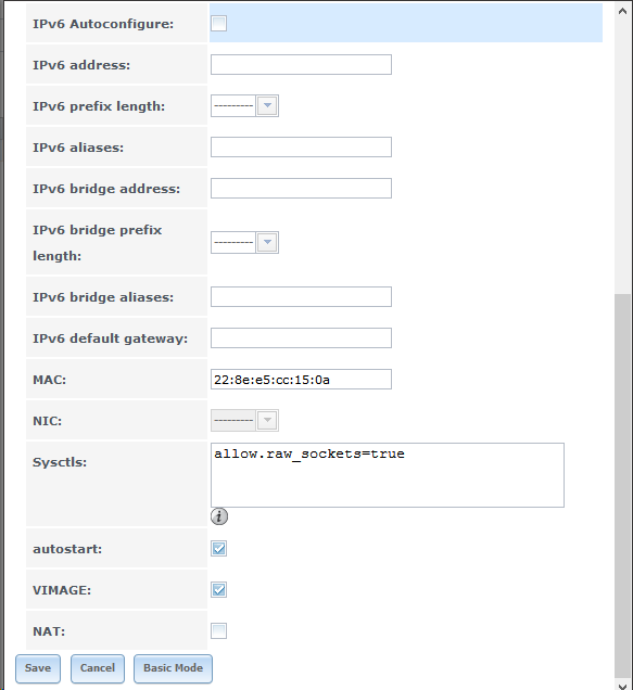

These are the global network settings on freenas

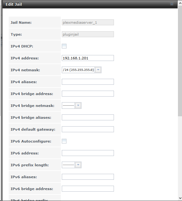

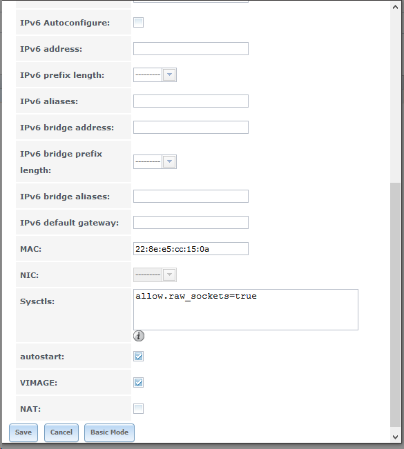

This is the jail settings for PLEX
So after discovering that i can access PLEX on my local network, it must be that i am unable to access via internet which is what i would be doing on my laptop browser and my phone browser.
But...which setting affects outgoing traffic?? And is this even the right question?
Anyway - i am getting close to just doing without until i upgrade to 11.2.1 or whatever it is and maybe ill get the cool new interface!
Please let me know what you think and thank you for your time thus far.

9,700
Your plex server will never get out with a blank default gateway... you need to set that to your router IP and it will probably start working right away (after a restart perhaps).
In the Jail? I noticed that there were a lot of blanks, but i havent changed these settings since install so i thought best not to touch it. Ill give it a try and report back.

Because your FreeNAS box has access to the internet @sretalla's suggestion would certainly be my next guess.

Did you change any of the plex network settings? For example, prior to things breaking did your Plex server have a subnet mask set or NIC selected
The Jail had a subnet of 255.255.255.0 for IPv4, but no NIC selected. Also DCHP is off.
Does this mean the default gateway on the router? I changed it to the default gateway listed on the internet setup page and i changed it to the usual default gateway and i got this in the green writing

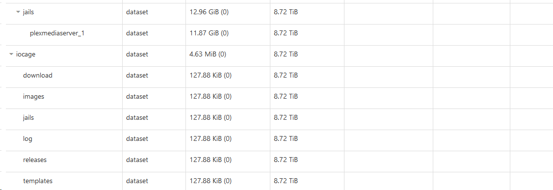

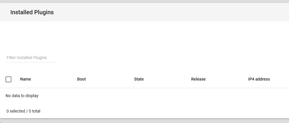

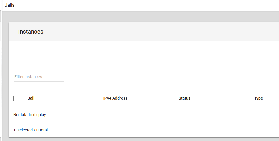

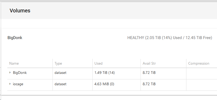

I also just saw this in the new UI
It shows, old jails AND iocage jails. I have no idea how this might contribute to the problem
