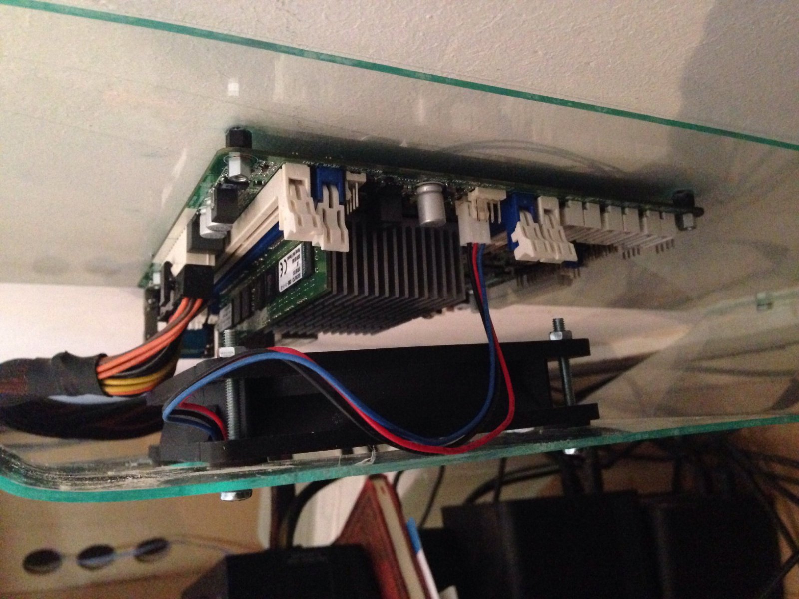

krikboh
Sep 21, 2013
209
I see in your picture you have an "unorthodox" enclosure. Some motherboards do not react well to being mounted in a non-metallic enclosure because they use the mounting screws as electrical grounding points. Could the random errors also be EMF interference because of the enclosure?
Vincent Jansen
May 16, 2014
82
That,.... I did not think of. Monday I will add some ground wires. Hope it will resolve some possible static buildup. Will comment back as soon as I'm done.
Shouldn't be a problem since everything ends up sharing the PSU ground.

no_connection
Dec 15, 2013
480
That's not entirely true. Ground works completely different when you get higher in frequency.
While I could argue that the MB would be badly designed for not being able to handle free mounting (some MB even comes in a box that can be used as a case for it) there might be EMI sources that you normally not detect causing problems.
It might also be ESD damage considering the plastic environment.

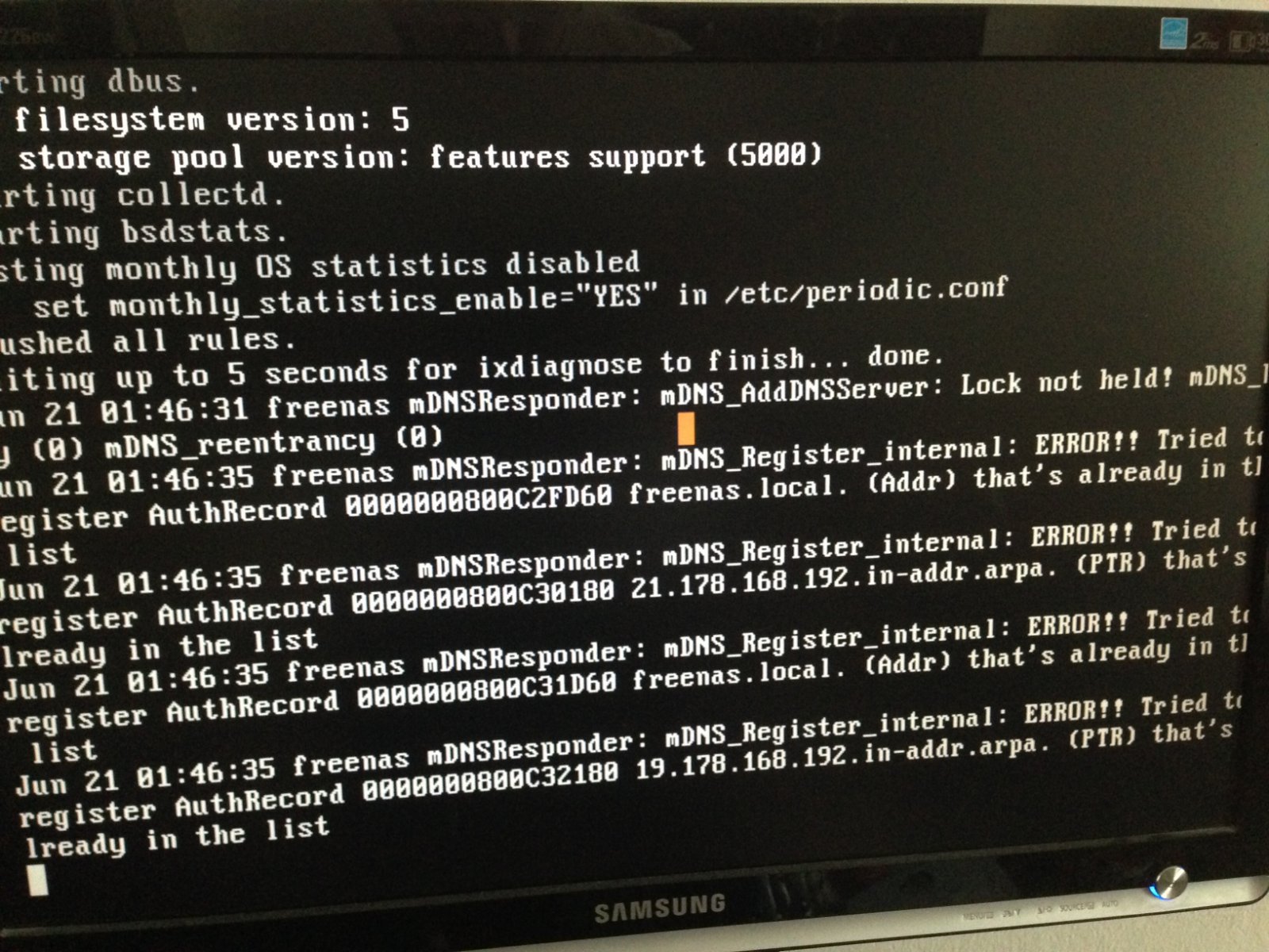

Vincent Jansen
May 16, 2014
82
okay, I tried a reinstall. Removed the USB stick, erased it and put a fresh image on it (following the procedure)
after booting it halts at this...
whats going on?
