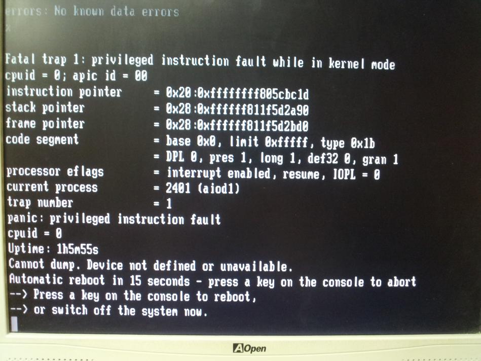

I have attached a picture I took of my monitor after a crash
So a box I setup for someone with the 8.04 p1 keeps crashing and I believe I am correct that is the aiod from cifs causing a hardware kernel panic. I was thinking of setting up a second USB drive and mounting /var/log there to capture the actual dump file as that fails when freenas crashes. Should I turn off AIO or find what is going on here? How slow will transfers become if I turn AIO off?
Any advice is most appreciated.
