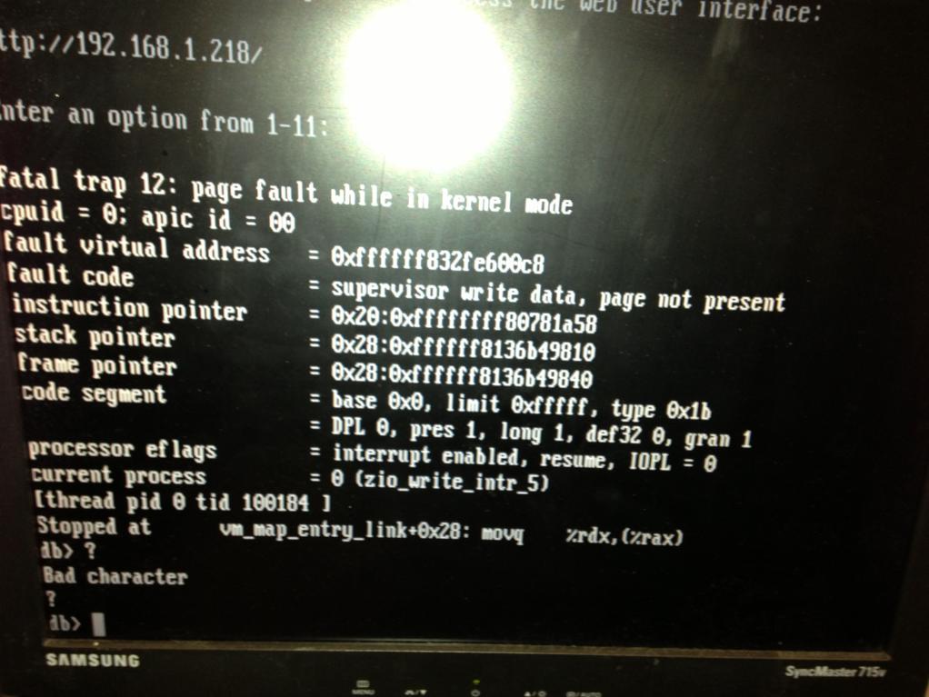

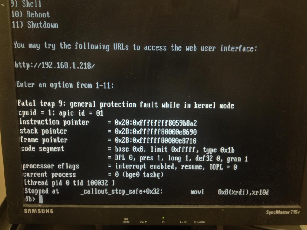

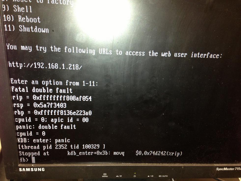

Hi everyone,
I'm getting a vm_page_free kernel panic whenever I try to read data off of my freenas system. I am running 8.2.0, 64 bit, and have three ST3000DM001 in a RAIDZ configuration. I have 6GB of RAM and have a Q6600 processor with an ASUS P5KC motherboard. There are no custom tunables I have entered (it is a "stock" freenas install, with only the RAIDZ setup.) I have selected force 4096 sectors.
The interesting thing is that it seems to lock up in the same place for every file. For example, one movie I have can consistently get through copying off 5+GB but it always crashes at the same area, while other movies I try to copy off make it consistently kernel panic within a GB of transfer from the beginning. I just did a full memory test this morning and found zero errors. Any ideas? How can I further diagnose this? I have tried removing memory one stick at a time, in different slots for each stick. No memory stick combination gives different results.
http://forums.freenas.org/showthread.php?9138-Panic-vm_page_free-HELP&p=39346&viewfull=1#post39346 That post makes it look like it somehow might be corrupted data on the disk that's making freenas kernel panic...
pindex(505056), busy(1), VPO_BUSY(0), hold (0)
panic: vm_page_free: freeing busy page
cpuid = 1
Dump failed. Partition too small
Automatic reboot in 15 seconds - press a key on the console to abort.
