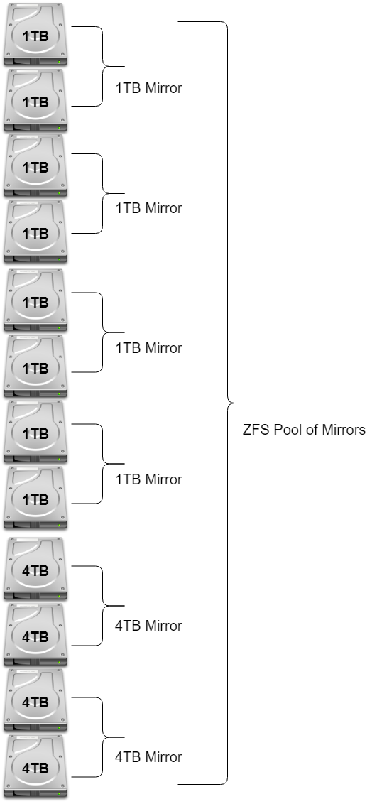

Is it possible/wise to build a pool with 4x8tb + 8x1tb in mirror ? I have a bunch of 1tb for free...
It is totally doable to make a pool such as this, however it would give you around 10TB of usable capacity. You would be able to replace the 1TB drives later to increase capacity.
Since this system is for backup, and speed is the big issue, I think this could be reasonable, but keep a close eye on drive health.

10tb ? not 12 tb ?
Just off the top of my head, but a drive that is sold (I mostly hate marketing people) as being 1TB is actually only around 877 MB of real usable space, so the 8 x 1TB drives should give you about 3.5 TB of space. The 4TB drives suffer similarly from marketing hype and you should get around 7 TB of usable space there, so probably about 10.5 total and you need to keep the pool under 80% capacity or you can run into performance issues related to the copy-on-write nature of the ZFS file system.
my 1tb are new (thanks to notebook shipped without ssd...)
Notebook (2.5 inch) drives are not high performance by any means. Probably around 100 IO/s per mirror set on those. What kind of 4TB drive are you looking at?

ok for the 10tb. but
You got wrong. I'm going to build 4x8tb not 4x4tb. seagate ironwolf.
if notebook drive are slow, should I just 4x8tb
And I made a mistake, today I have a "slow" freenas with 3x6tb red
Sorry, I don't know where I got the idea it was 4 x 4 TB drives.. That changes the capacity a bit, but the number of vdevs will still influence the overall speed of the pool. The 8TB drives have a max data rate of 210 MB/s, so you should see (with two mirror vdevs) around 400 IO/s if you just use the four drives as two mirror sets. If you add the additional 8 drives as additional mirror vdevs, it may improve overall throughput to the pool because read and write operations are paralleled across more vdevs. I have not tried using notebook drives in a storage pool, so I am not sure how well they will perform.
