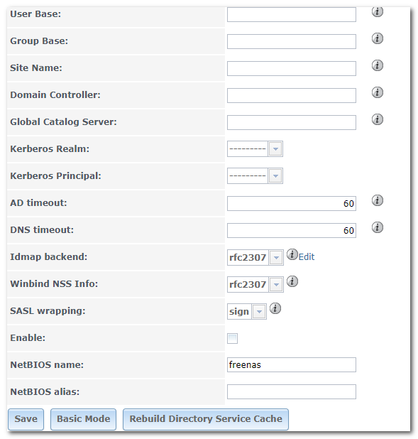

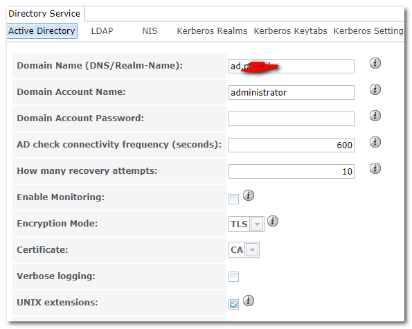

The attachment is directory service.
when I click "save" button, errors raise up with
  • {'desc': 'Connect error', 'info': 'error:14090086:SSL routines:ssl3_get_server_certificate:certificate verify failed (unable to get local issuer certificate)'}
juding from error, it seems that FreeNAS does not recognize CA's ceritificate(ca.pem) . If it's centos /debian I would like to add ca.pem to system cert store and update-ca-cert. But for FreeNAS, I don't know how.
So what's wrong with my setup? I also wonder where does the related log locate? /var/log/messages shows nothing useful.

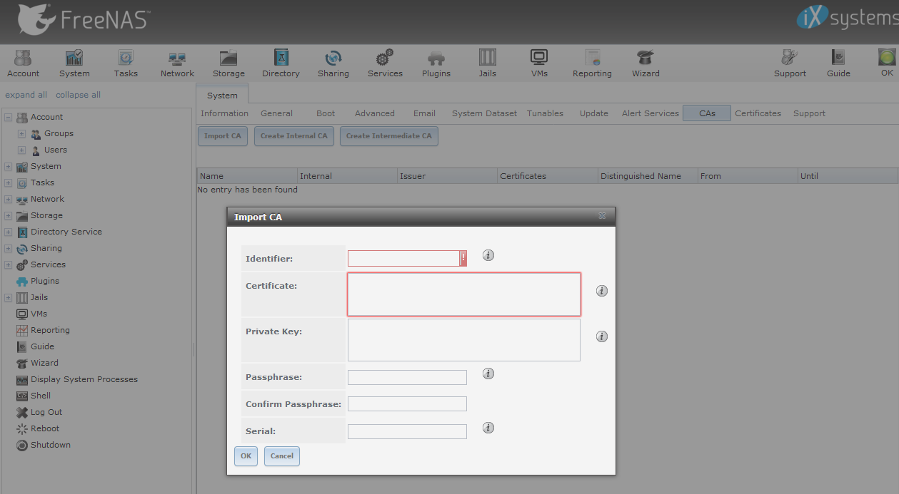

Is the AD DC another system, or the FN box? Will the FN box be the CA or you generate the certificates elsewhere? If this is the case, have you tried to import the CA certificate as in the image below?

I generated CA (ca.pem) on FreeNAS ( System ->CAs) and then signed a cert/key with this CA for Samba DC, as mentioned in the post cert.pem/key.pem.
So FreeNAS is the CA.

Create CA and import to FreeNAS also works.

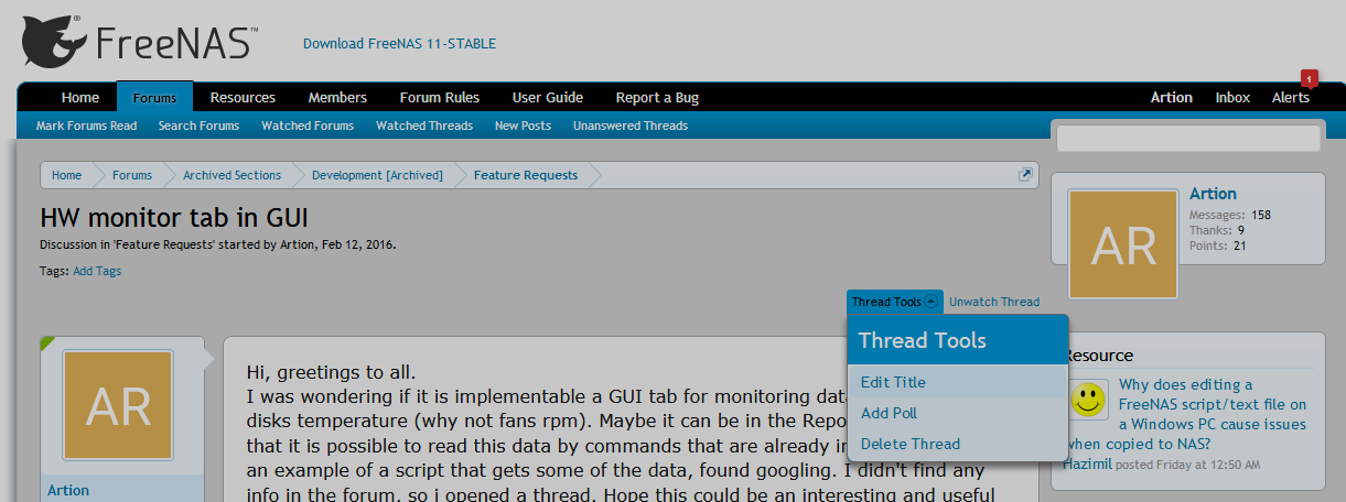

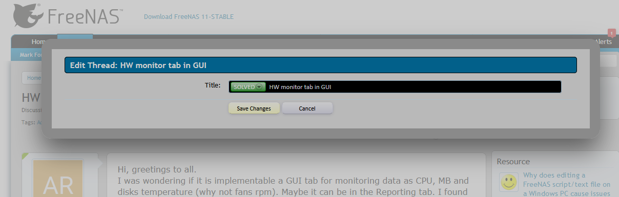

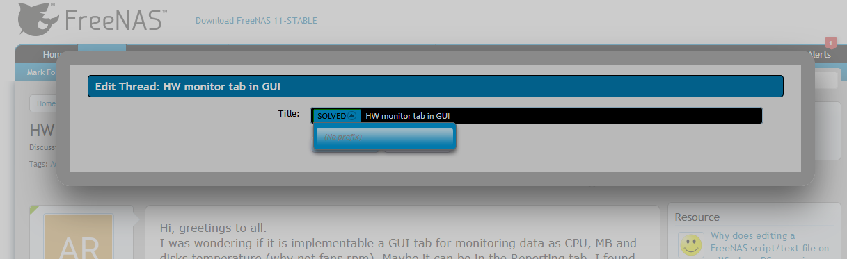

This is how it's done:
1. Click on Thread Tools -> Edit Title
2. Select SOLVED in the Prefix dropdown menu
3. Save changes
