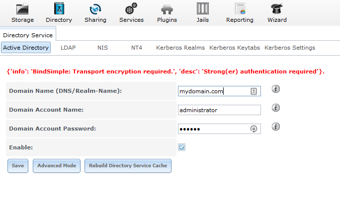

Recently my FreeNAS Mini (FreeNAS-9.10-STABLE-201605021851) won't join to my Samba AD DC anymore and will spit out the following message:
{'info': 'BindSimple: Transport encryption required.', 'desc': 'Strong(er) authentication required'}.
Screenshot of this is attached to this post.
My Samba AD DC (Version 4.2.10) is running Debian Jessie and from what I understand so far, it's not playing nice because of a security vulnerability that was patched in Samba. I tried switching to TLS encryption mode on FreeNAS, but it kicks back a message saying it doesn't want to use a self-signed certificate. I can join Windows machines to this AD DC, but FreeNAS doesn't seem to want to cooperate. FreeNAS will join perfectly fine to a Windows 2008 R2 AD DC though. I also fired up a fresh VM of FreeNAS and Debian Samba AD DC and it will still throw this error.
Anyone have an idea what could be going on?

Based on some work I've done recently on AD with FreeNAS, here's some info that may be useful.
1. If you are using AD, you can only use self-signed certs if the entire cert chain is made available to the FreeNAS. That means that the CA must be on the FreeNAS that signed for the AD certs.
2. You must use TLS 1.2 or higher when using Samba 4.3 (which is available on the version that have the badlocks patch), the most recent and one prior version if memory serves me right.

Your advice put me in the right path to getting it working, thank you!
Here's what I did in case anyone else gets stuck on this problem:
I created a CA and a certificate in FreeNAS and copied them over to the Debian Samba AD DC server. Then I added the following lines to the Samba server configuration file in the global section:
tls enabled = yes
tls cafile = /path/to/cert/samba-root-ca.pem
tls certfile = /path/to/cert/samba-cert.pem
tls keyfile = /path/to/cert/samba-key.pem
I reloaded the configuration and joined FreeNAS to the AD DC after setting the following settings under advanced mode:
Encryption mode: TLS
Certificate: Samba Root CA
SASL Wrapping: sign
Having the certificate signed by a CA in FreeNAS worked and setting SASL wrapping to "signed" was what got it working again for me.

Hi All,
I was hoping someone might be able to give me a minute for some assistance. After completing everything above as far as creating the CA, and Certificate. Then exporting those to my Samba AD DS server. Further editing smb.conf, verifying permissions, restarting samba, also making sure AD DNS are still working. I'm getting a different error than what I see above from others.
On Freenas on the Active Directory under advanced, I selected TLS, then chose the CA, and changed SASL to sign. when I save I receive the error:
  • Connect error, TLS: hostname does not match CN in peer certificate
when creating the CA and Cert. should I have made the Common Name: freenas.mydomain.lcl?
Icarus_XI
Jan 19, 2017
5
Update:
Re-created the CA and Cert using the DC as the common name, now getting a new error message:
  • Connect error, error:14090086:SSL routines:ssl3_get_server_certificate:certificate verify failed (self signed certificate)
Icarus_XI
Jan 19, 2017
5
Final Update:
I was able to resolve the cert issue. Everything is now working as expected.
