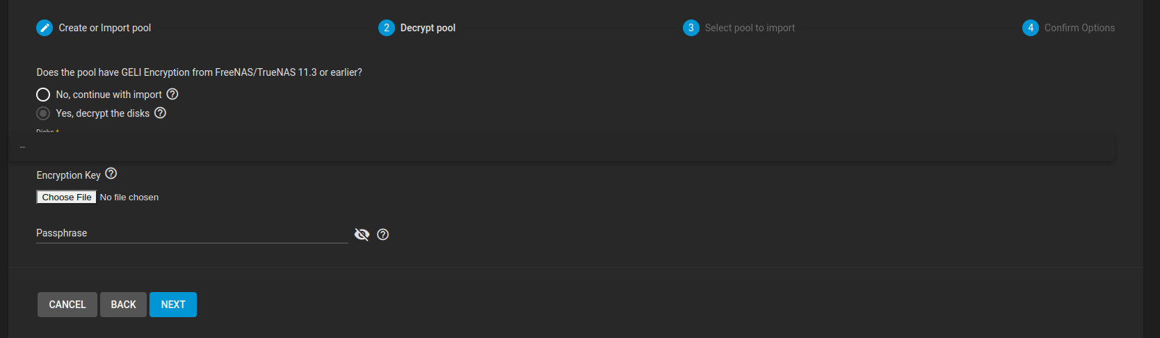

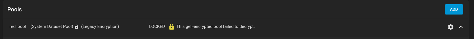

However, I'm stuck on the last step "Import pool through the TrueNAS GUI".
It does seem to have partially worked though because I can now boot with all the drives connected but the pool is encrypted and it seems that it can't be decrypted?
Here's what the GUI shows:
This other thread seems like the right approach but I don't want to disconnect the pool in case it breaks something. Ha.

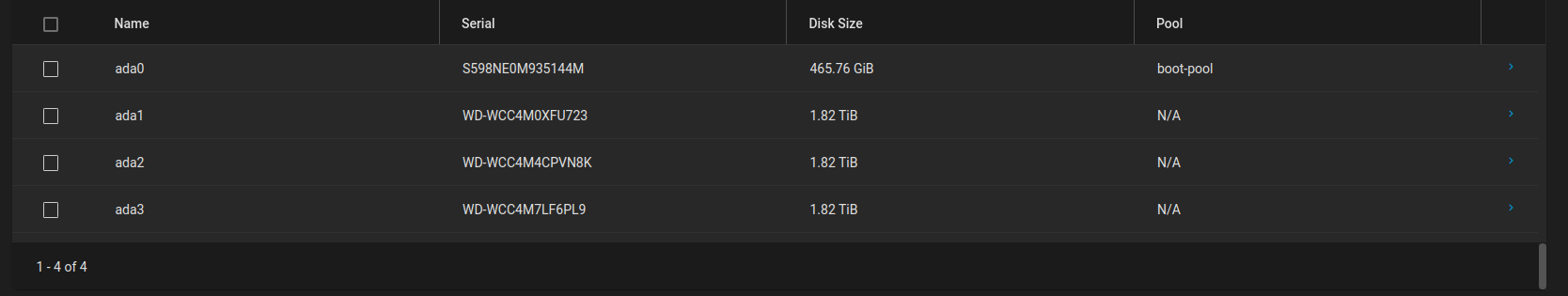

When I do try to import, without disconnecting the `red_pool`, it doesn't pick up any devices. As shown below:
They are listed in devices though. The strange thing is I don't remember the drives with those names, but I could be wrong about that.
Did you make a backup of the encryption and/or recovery keys after the pool was created, or take a manual backup at one point with the "Export Legacy Encryption (GELI) Keys" option checked?

That's a funny story but yes I do have the key.
Should I disconnect the pool and re-import it?
I'm interested in the funny story, but even more glad to hear that it won't be a tragedy if the answer had been "no."
Yes, and be absolutely certain that you don't check the "Destroy Data" option. On re-import, simply answer the same question "Yes, the pool is encrypted" and provide your keyfile/passphrase when prompted. It should decrypt the GELI layer and present the decrypted pool for mount.
