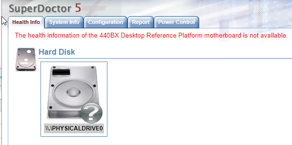

There is the snapshot of SD not working as it believes it is on a VM. It does pull some of the processor info through. The program is likely useless once I get IPMI up and running. I look forward to tinkering with it tonight and using all the info you have given me. In the mean time I put up a Nagios XI instance for one of my coworkers to explore. Much more to do, but the rails finally arrived at home, and with IPMI looking like it will be working by the end of the day, things are good.

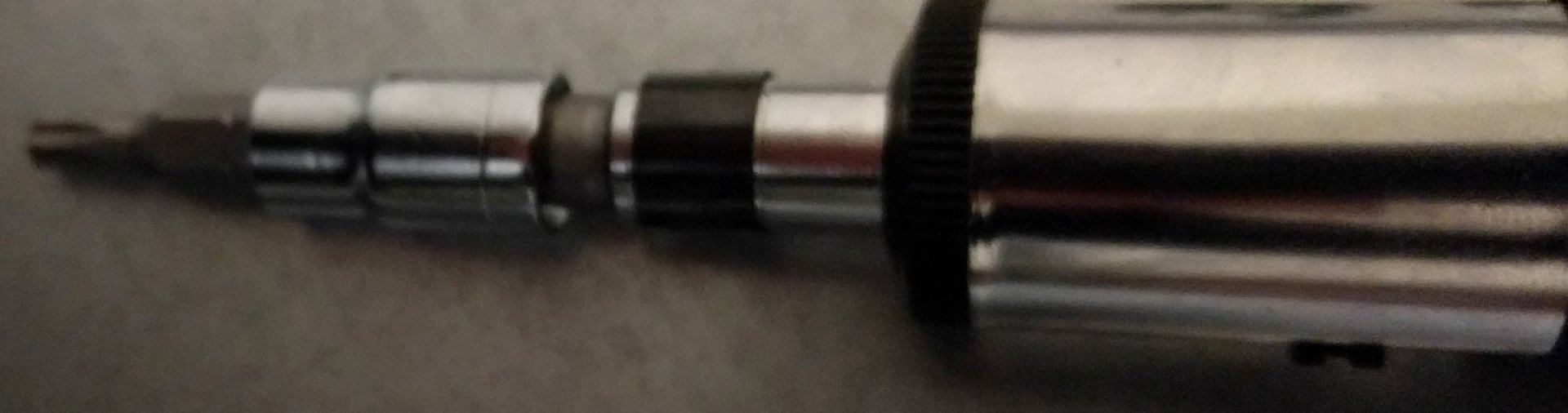

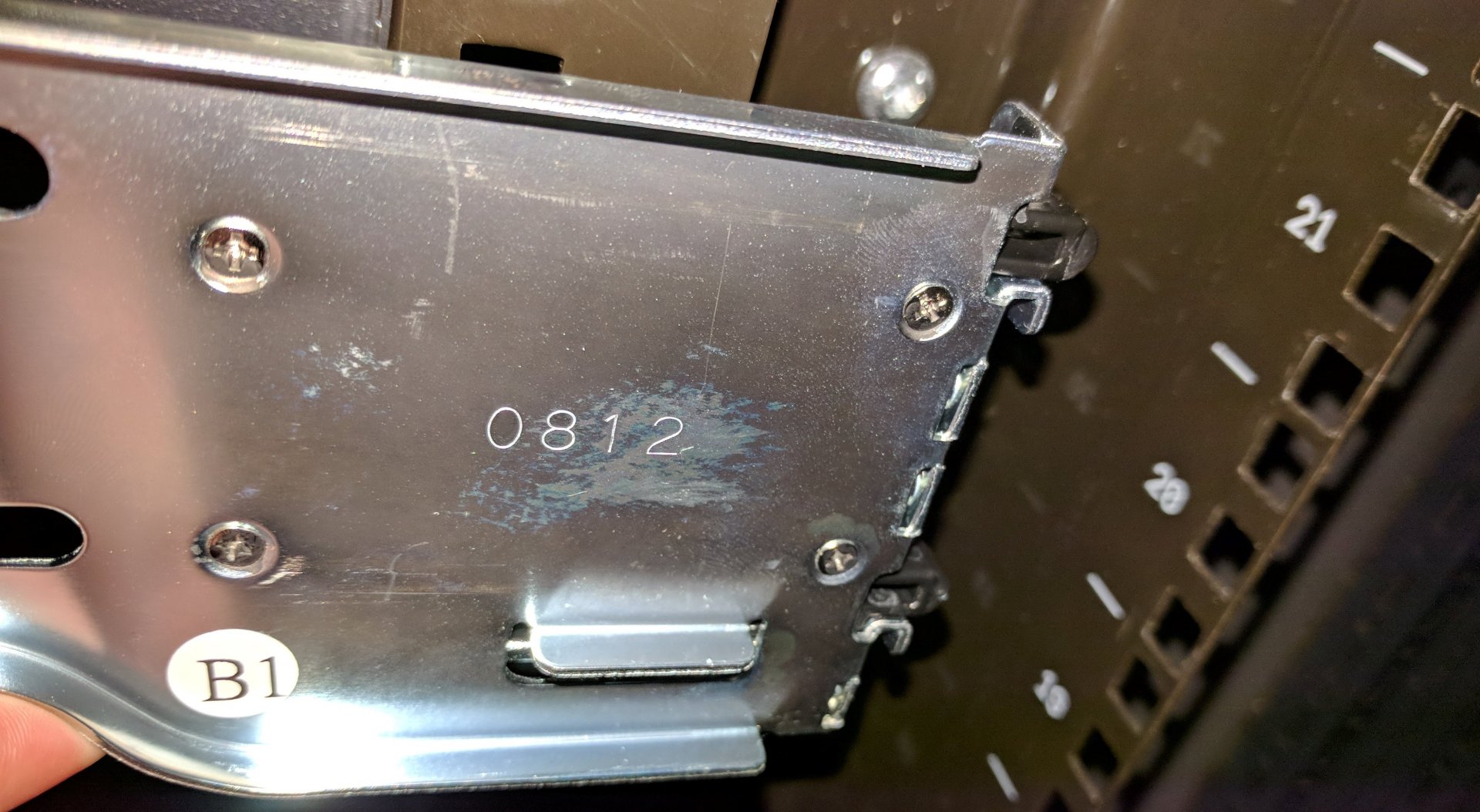

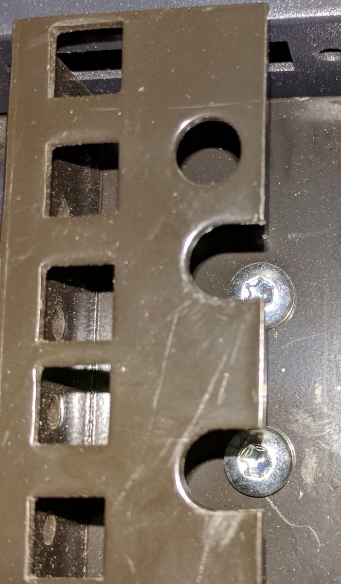

I am in IPMI now after battling with the rack/cage and learning how badly a second person is warranted in mounting this chassis. I ended up using the box the chassis was shipped in to hold the chassis up while I maneuvered the inside rail onto the middle rail (don't do this). Also, whomever put the screws in for the adjustable depth rack holes...wow. I have never had to work my zip gun that hard. I smelled burning oil and thought I saw smoke.
The rails for the chassis were about 2 inches short so I had to undo 24 T25 (Torque) screws to move the two mounting rails (vertical).
<-not nice
<- my first attempt at getting around the metal, worked for an easy screw
I had to run out to Home Depot real quick to get a longer T25 bit as they conveniently made a part of the rail guard it from shorter bits. I'd like to do more, but I am tired and to play some ESO before I get some sleep. I finally have the dang thing racked and I have access to IPMI.
P.S. - After adding the pictures I realized that I told the story in reverse order or at least jumbled...ahh well. Victory!

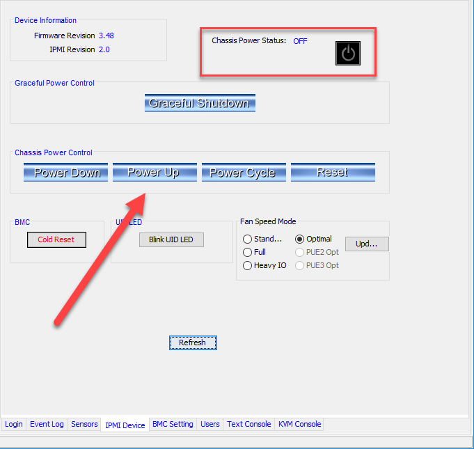

I'm glad to hear that you were able to get IPMI working. It makes everything so much easier.
To add a little more flavor to @ Chris Moore's commentary ...
View IPMI View you can see the "Chassis Power Status" is currently "OFF" ... all I have to do to bring the server back up is click the "Power Up" button. It is similar to WoL (Wake-on-LAN).

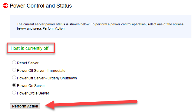

Similarly this can be achieved via web browser. Click "Perform Action" ("Power On Server" is already selected by default as the Host is off).
