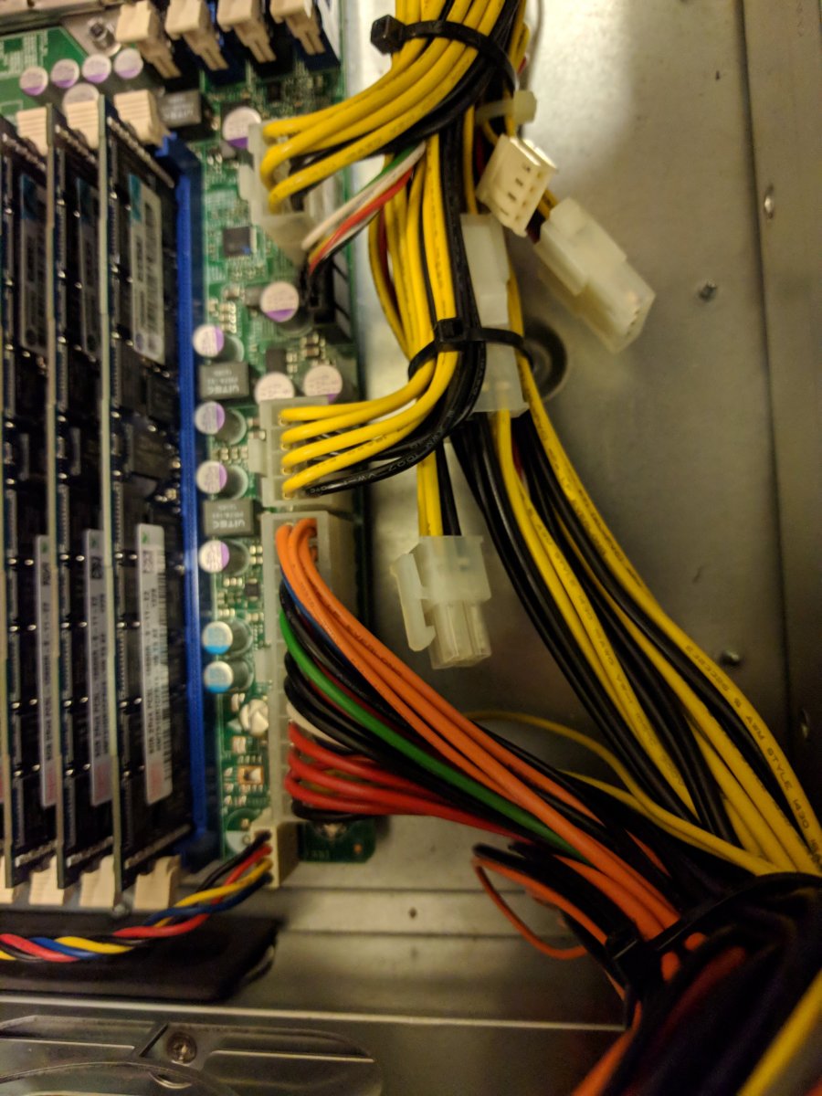

Edit - I think I have a few of those in my part bags. We should be good. That is one of the power cables that is exposed in his nice wiring so I will go with that. I thought about buying a second set of the SSD/HDD cage, or cancelling and trying to buy two of the $4 sets, but I will hold off for now. I though the second set of 2.5" bays could be used for the additional read and write cache's, but I think I recall these drives needing to be on the PCIe lanes...? Not sure, but may not need them anyway with the amount of RAM I have, we shall see. If I ever get to the point where I need either additional synchronous write or read cache, the $ will have been well spent anywho.
Edits continue: Aww heck with it, I ordered a second from the other seller for $14.99 with shipping. If I just bought Newegg out of stock and it is somehow worth the money for me to ship it to someone (who needs it more than I)...let me know. Yay for future proofing...maybe?
More pictures and such coming later. Of note, it appears I only have 1x 4 pin and 1x molex power adapters left. This mobo is a beast. There are so many pins set to things I will have to read up on, power cable attachments, and other doodads. A side thought, it is tempting to remove the high RPM fans and try to find a way to rig my Cougar fans into the case. There is plenty of room for them to fit, I think, it would just be a matter of designing mounts for them. I have 8x 140mm and 6x120mm HDB Cougar fans that I used in my early life crisis case mentioned earlier in this thread. I will be taking videos to compare and contrast the sound levels with each fan setup. More to come...

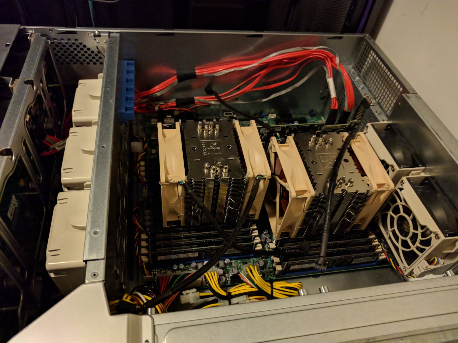

Update 3/12/18
Over the weekend I had a chance to do some further testing, install the active coolers, and I received all parts except for the server rails. What follows are the results of the tests, issues, and solutions. Finally, I have a few questions for those with X9 Supermicro motherboards.
Sound testing
  • First, and most importantly, the wife test. After my wife was settled in and my child asleep I had turned on the server and had her give me some more feedback. The great news is that the loud "whine" she heard last time was the alarm from having both PSUs in without both being plugged in. As I won't make that mistake again, this saved me $140 for new PSUs (at least for now). She also stated that the noise level was acceptable, which is also good because that was without any modification and should be the loudest they should be.
  • I took a few videos, but the files seem to be too large and the noise cancelling / lack of scientific approach / lack of measurement device makes them less valuable. If anyone would still like to hear/see the footage please just ask.

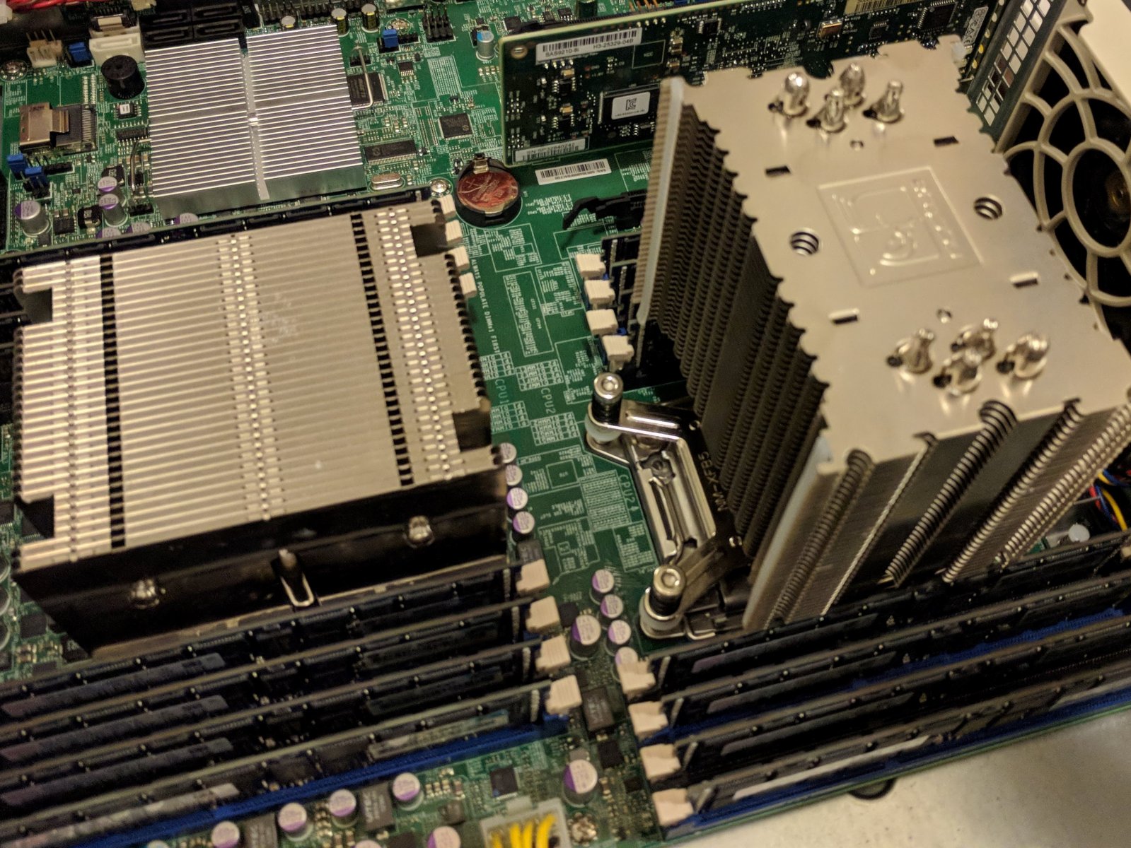

Replacement of Passive with Active CPU Coolers
Yuck, the paste on the passive coolers was all over the place. I had to take the CPU out (neat little learning experience there, double locks!) and clean it and the socket.
This is a comparison of the old, passive heat sink vs the new, active heat sink (without fans yet). It took me a good few minutes to read and understand the directions of how to switch and fit the base supports for the block to the Narrow ILM socket. The plastic retention/safety circles required brute force via pliers and were a pain to get off and move over. When I applied the fans though, I had some clearance issue initially...

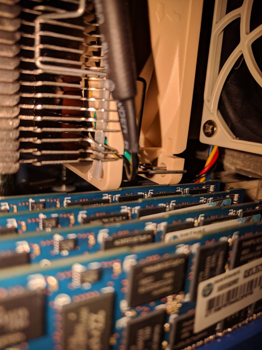

Luckily though, the fans were easy enough to adjust. I ended up having the power cables from the fans come out the top so I could steer clear of the RAM.
The finished product with the loose wires...
Speaking of wiring, I do have the Molex-2x SATA power cable for the ESXI SSD drive(s). I hope that I can use the 64GB SATA-DOM to redundantly install both ESXI and FreeNAS, but I don't want to limit the SSD's 500GB capacity. I will have to see how that goes. I do however have a newly discovered issue. I have 9 fans and 8 fan headers. The good news is that I can use previous experience and equipment from my water cooling build to fix this. My questions are...
  • Does anyone know the amperage or total wattage that the X9 series motherboards can provide via their fan headers? I would only need one of these fan headers to run 2 fans and I could make them two redundant(ish) fans.
  • Has anyone done a comparison on fan speed and noise when using either software to control or hardware (undervolting)? What are your experiences? I wanted to try the software first, as I could control it remotely with IPMI and without the need to add additional components to the build, but if undervolting with resistant wires works better, I have he parts for that too.
I am excited. The rails come Tuesday :)-/), but I may start with the ESXI install and get familiar with the BIOS(es) tonight.
Edit - the supermicro page for the chassis states 8 fan headers for 8 fans. I will look up the draw on the chassis fans vs the draw on the Noctua fans to get a better idea. Noctua Input Power 0,96 W from https://noctua.at/en/products/cpu-cooler-workstation-server/nh-u9dx-i4/specification and the chassis fans are 0.6 and 0.35 amp for mid and rear fans respectively. I can't recall the formula exactly, but I think the Noctua fans are far under the chassis fans. 12v fed * amp - Watts. So a 1 watt Noctua fan is 0.125 ish amps or a third of a rear fan.
