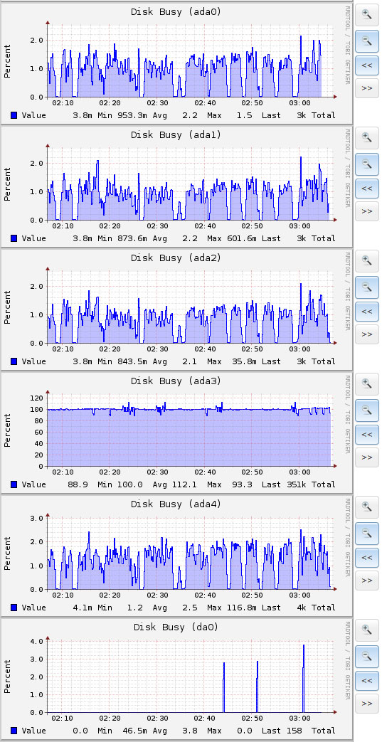

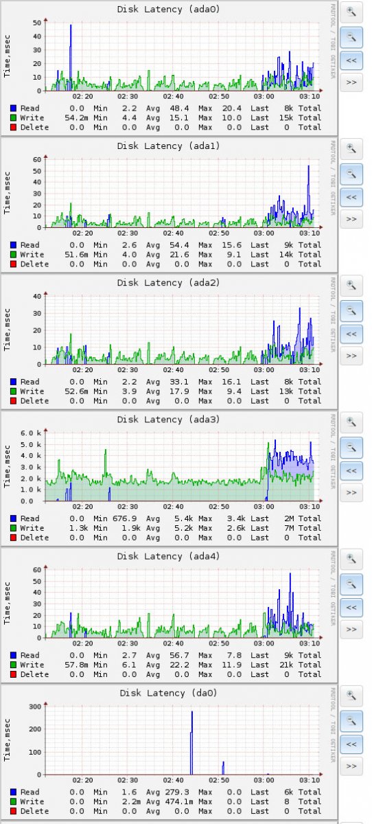

one thing I have noticed is that ada3 does seem to be on 100% disk usage (when checking disk busy under reporting) and the disk latency also seems very high... could this be the culprit? what could it be doing? is there a way to check?

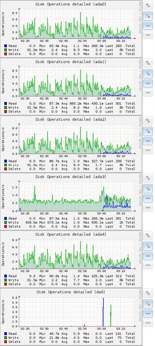

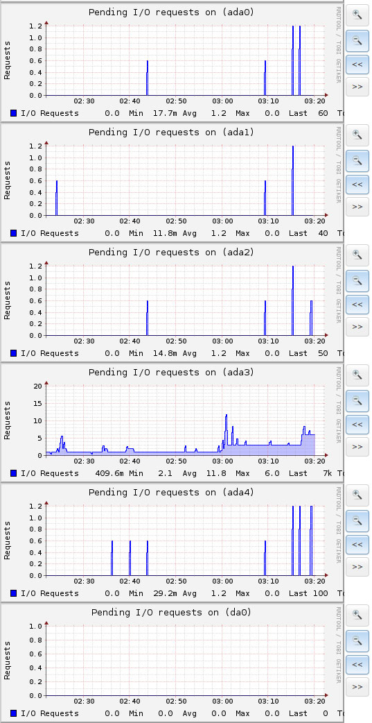

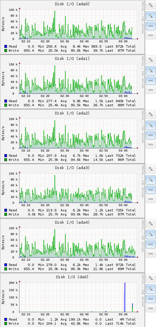

I could give that a shot, but what if the problem persists? is there no way to see what activity is happening on the drive so that i could try end the process?
This is what my hardware reports for the drives looks like:

The pool drives run as an array and the activity should look the same.
ada3 looks like it is internally busy, possibly doing some kind of correction/recovery.

Anyway it would seem that the activity has now dropped from a constant 100% to now spiking between 60% and 80% on ada3
the rest of the drive are still going between 2% and 5% activity
