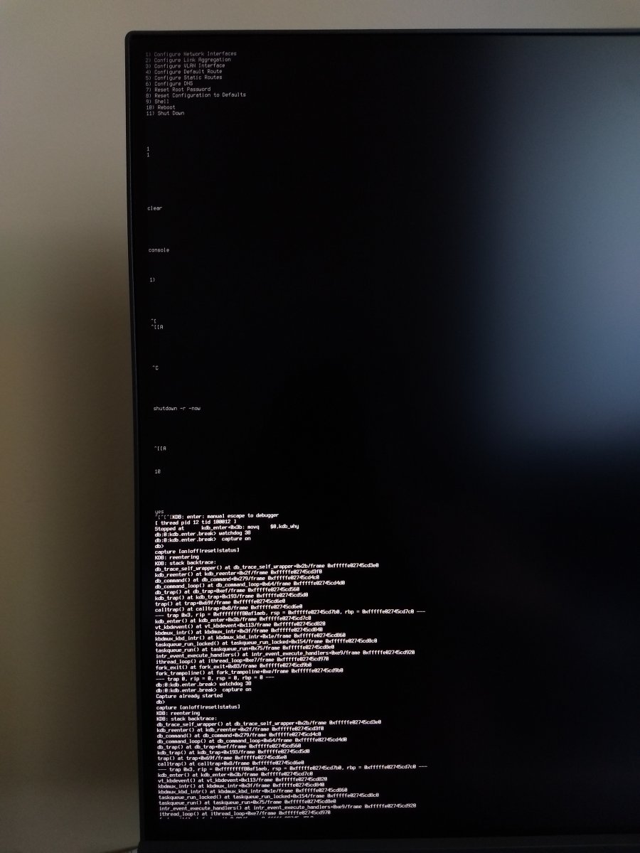

Ok, so this time, upon plugging a monitor, console shows up. But it's hard to read (4k resolution, last couple of lines are below what the monitor is printing).
Here is a screenshot of the console (the blank lines were me hitting enter trying to bring the text up to read the result. Last command was ctrl+alt+esc and now nothing more happens).
Still inaccessible through network, although the router indicates it's got the up assigned).

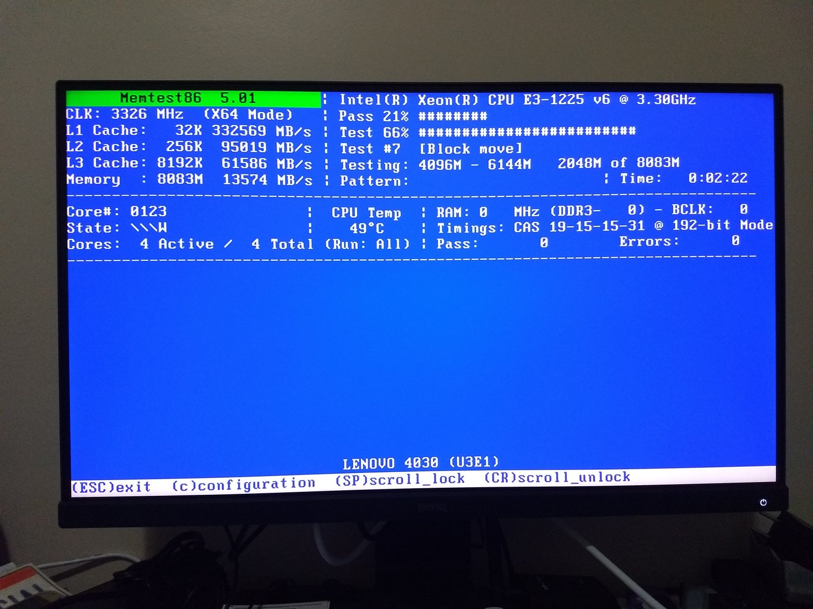

Ok so I decided to run memtest, forced multitasking, and now then it got stuck in this:
Won't answer to keyboard, and keyboard lights are unresponsive (caps lock was on, and it remains on no matter what. Num and scroll lock are off and so they remain).
Hard power off.
What now? :(

Allright, ignore last post. I was running the multithreaded version of the test, which by the internet's accounts, is buggy.
I've succesfully run the single thread test again and all is going well.
