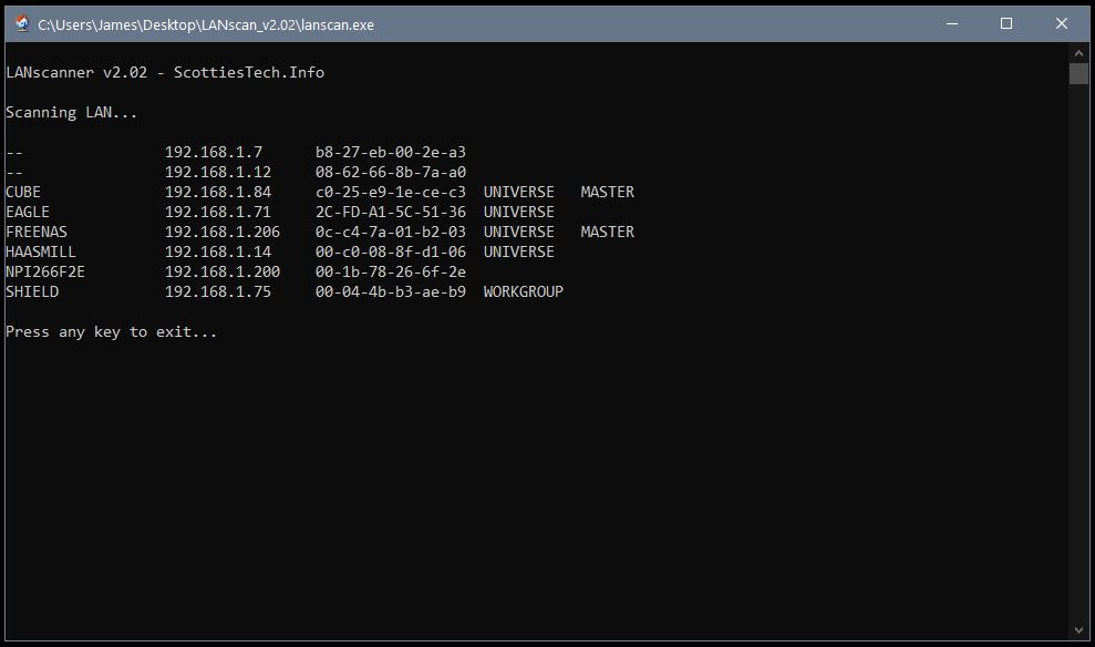

Update:
Dug into the master browser idea a little and here is what I found.
Using the Lanscan I see that the Freenas server is registered as the master. I also see where one windows machine is also registered as the master. Machine varies and appears to be random.
There is a checkbox for master browser in the settings for SMB. Unchecking it, rebooting and it still shows up as master.
Possible bug?
However, so far today I am able to access the mill freely with no "waiting" period.
We'll see how it goes as the day wears on.
