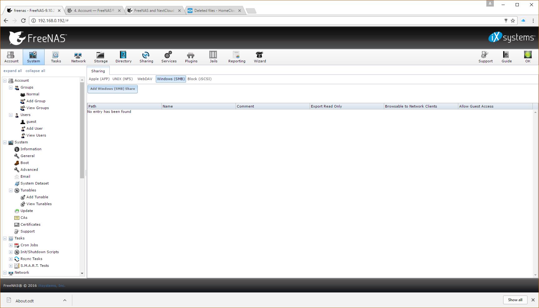

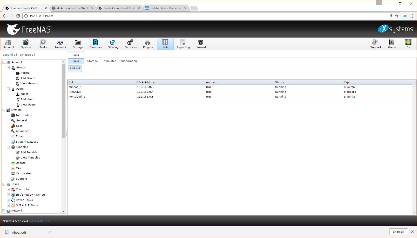

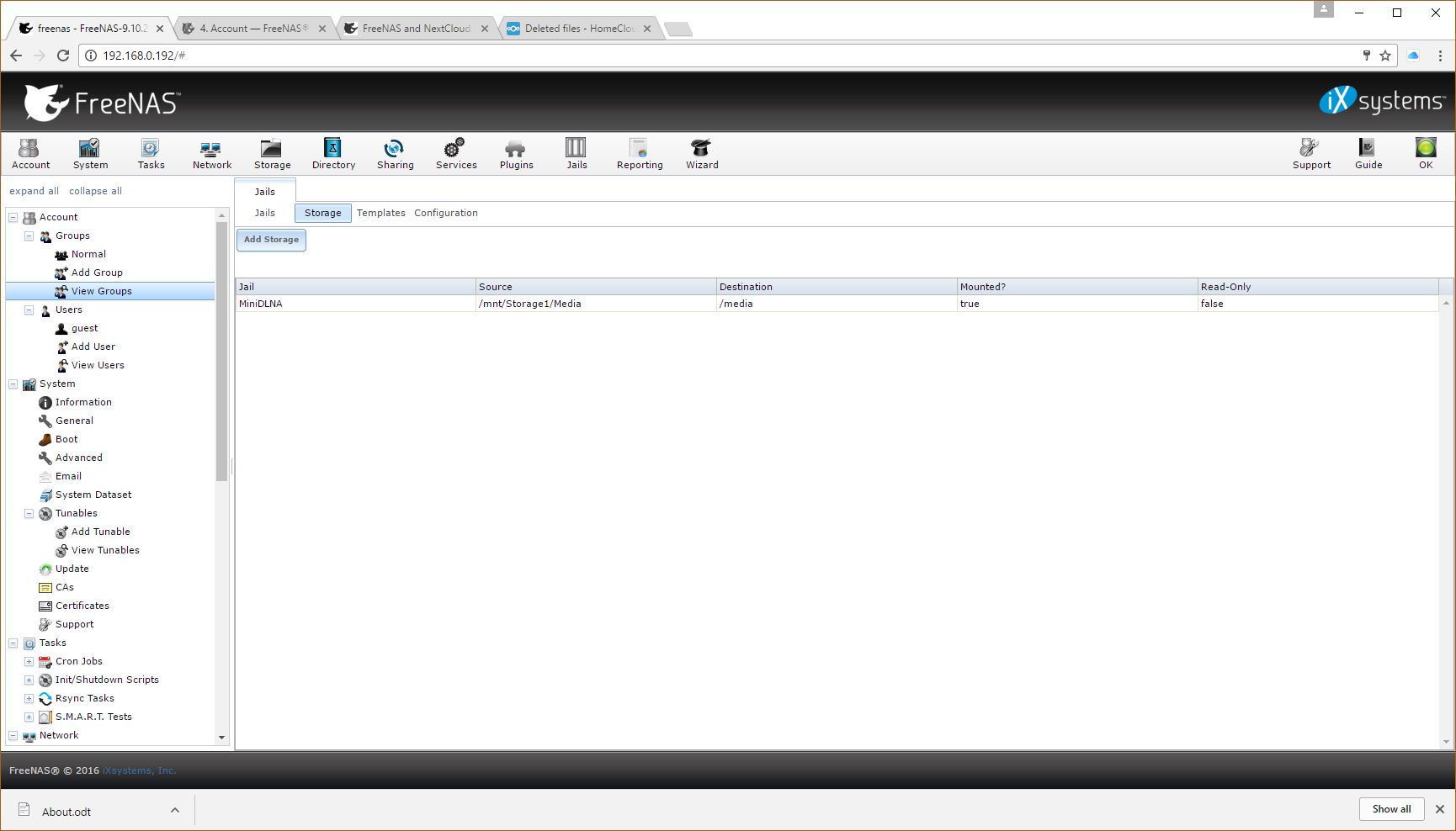

I am really struggling with this.
I cant figure if I am supposed to create a windows share, or a dataset or a new user with a home directory or anything, its blowing my mind a little bit now.
I have attached screenshots, I hope it is allowed and I hope someone can help me get this right.
Thanks so much in advance.

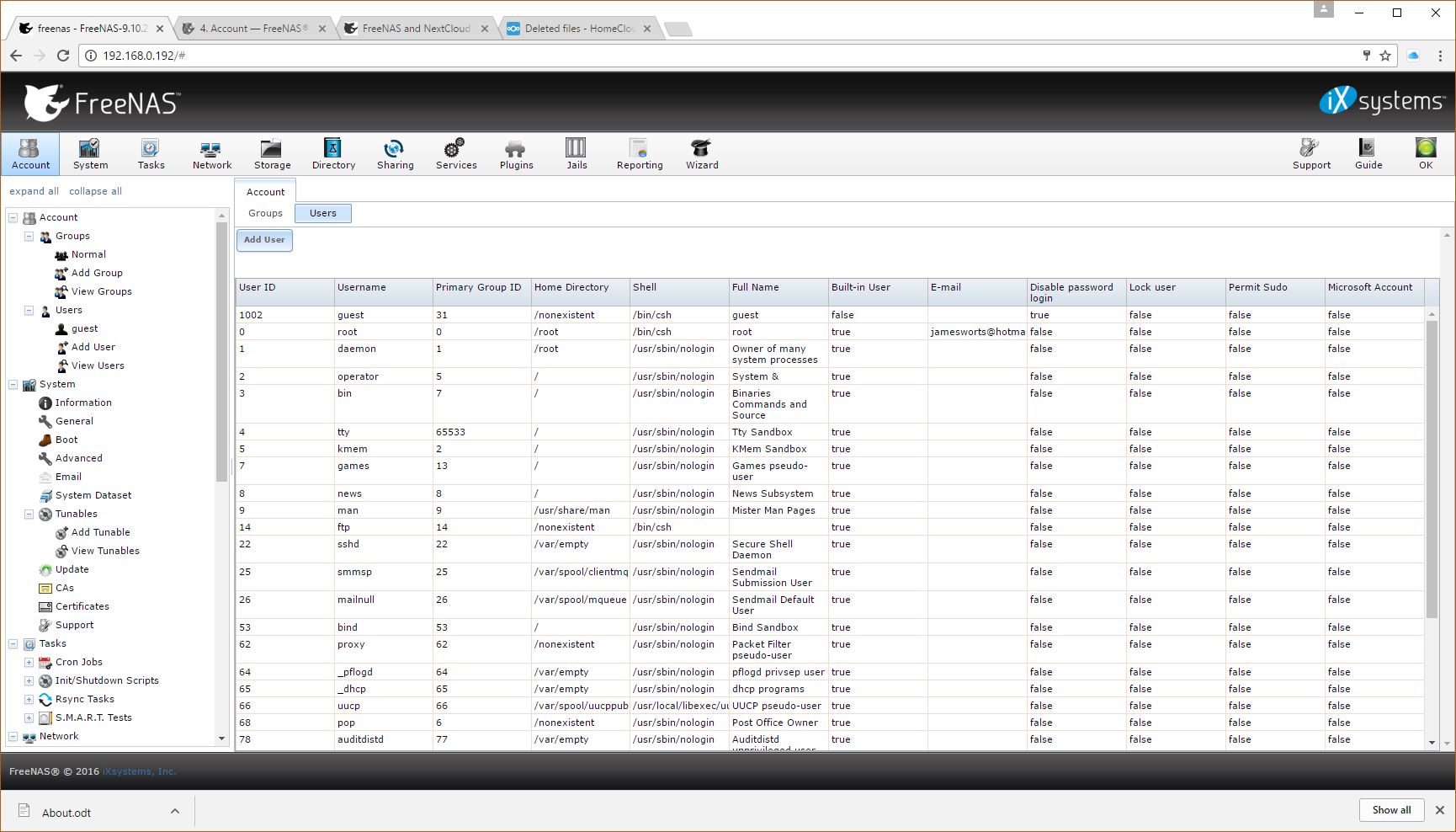

Ok. First thing - go to Jails tab. Select the NextCloud jail. Click the "shell" button down the bottom, the shell for the jail will appear on screen. Type 'cat /etc/passwd | less' with no quotes. It will fill the page with users, down the bottom of the list will be the users you are interested in - I ****THINK**** the UID/GID you want for this is the one called "media", for me it is UID 8675309. You can then create a new user in FreeNAS called "NextCloud" and they can either own or be in a group that owns the NextCLoud Dataset - This dataset is not the one you see under jails in your screen shot, it's a separate one you need to create.
I'm open to suggestions from others if there is a better way to do this by the way :)
Now you should have a user in FreeNAS with the same UID/GID as the "media" user in NextCloud
You should also have a dataset for which the FreeNAS user you just created has read/write access.
Have a crack at that and we'll go from there.

Go to jails tab, then click 'storage' (under jails, not the main storage tab)
Click 'add storage'
Select the NextCloud jail, select your dataset as the source, set destination as /mnt/james
