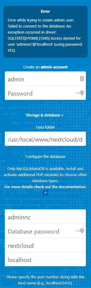

I've played with Freenas a few times and would now like to roll it out. My main requirement is for Nextcloud to run on it but I've hit a hurdle:
Installed Freenas onto suitable hardware (i7, 8GB etc). All running OK. Added a Pool and a Dataset.
Installed Nextcloud via the plugin method and can get into the setup screen no issue. The problem is that when I try and setup the admin account, no matter what options I try, it comes back and says:
error while trying to create admin user: Failed to connect to the database: An exception occurred in driver: SQLSTATE[HY000] [1045] Access denied for user 'adminnc'@'localhost' (using password: YES)
Anyone got any suggestions please? Screencap attached.

Hi -- kind of hard to debug your specific problem without details. Seems like you don't have the right admin name or password.
For installing nextcloud within jail, I used these instructions. They are very thorough. https://www.samueldowling.com/2018/...n-freenas-iocage-jail-with-hardened-security/
Worst case scenario in your case (since you have a fresh installation), would be to totally destroy the database and start fresh.

It's a long time since I used the Nextcloud plugin (it was called ownCloud) but it only worked with the sqlite database and not mysql. That might be the problem here, but I'd strongly recommend searching the forum for Nextcloud and using one of the excellent guides to set this up using an iocage jail and not a plugin.

The Nextcloud plugin is pathologically bad, and iX haven't shown the slightest interest in improving it. Either install manually, or use my script:
