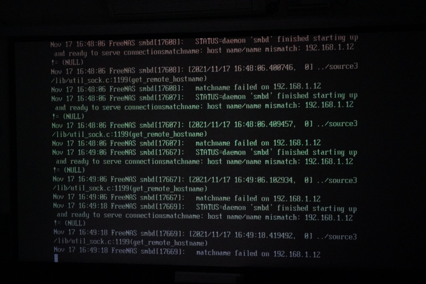

Couple of days back , my freenas GUI showed a critical error - Boot volume state is UNAVAIL ; one or more devices are faulted in response to IO failure
following this the GUI became unresponsive , on restart the boot loader screen got suck in the following
i read through some forums and discussion , most of them said it would be a failing / failed usb boot drive .
i panicked and googled for my version of freenas iso (FreeNAS-9.3-STABLE-201412090314) . it was no were to be found.
more panic set in . Some how managed to find a 9.3 version (FreeNAS-9.3-STABLE-201504152200) . i installed it on a new usb drive and booted my OS , logged into the new OS and setwizard showed up . and i did the following ,
then GUI would not respond . i restarted the server and the boot loader got stuck again in as in the previous boot loader image .
Then the next day i inserted the old usb drive (kingston 4 gb ) and booted my freenas server. It booted up fine and ran with no errors for 2 hrs.Then the same Critical error on GUI - Boot volume state is UNAVAIL ; one or more devices are faulted in response to IO failure and boot loader go stuck on rebooting my freenas server.
I then changed the usb port from on the moterboard to rear IO usb port , the system booted up and is running fine for past 3 days , even after multipe reboots and multiple manual shutdowns. USB header or connector on motherboard gone BAD ? ??.
