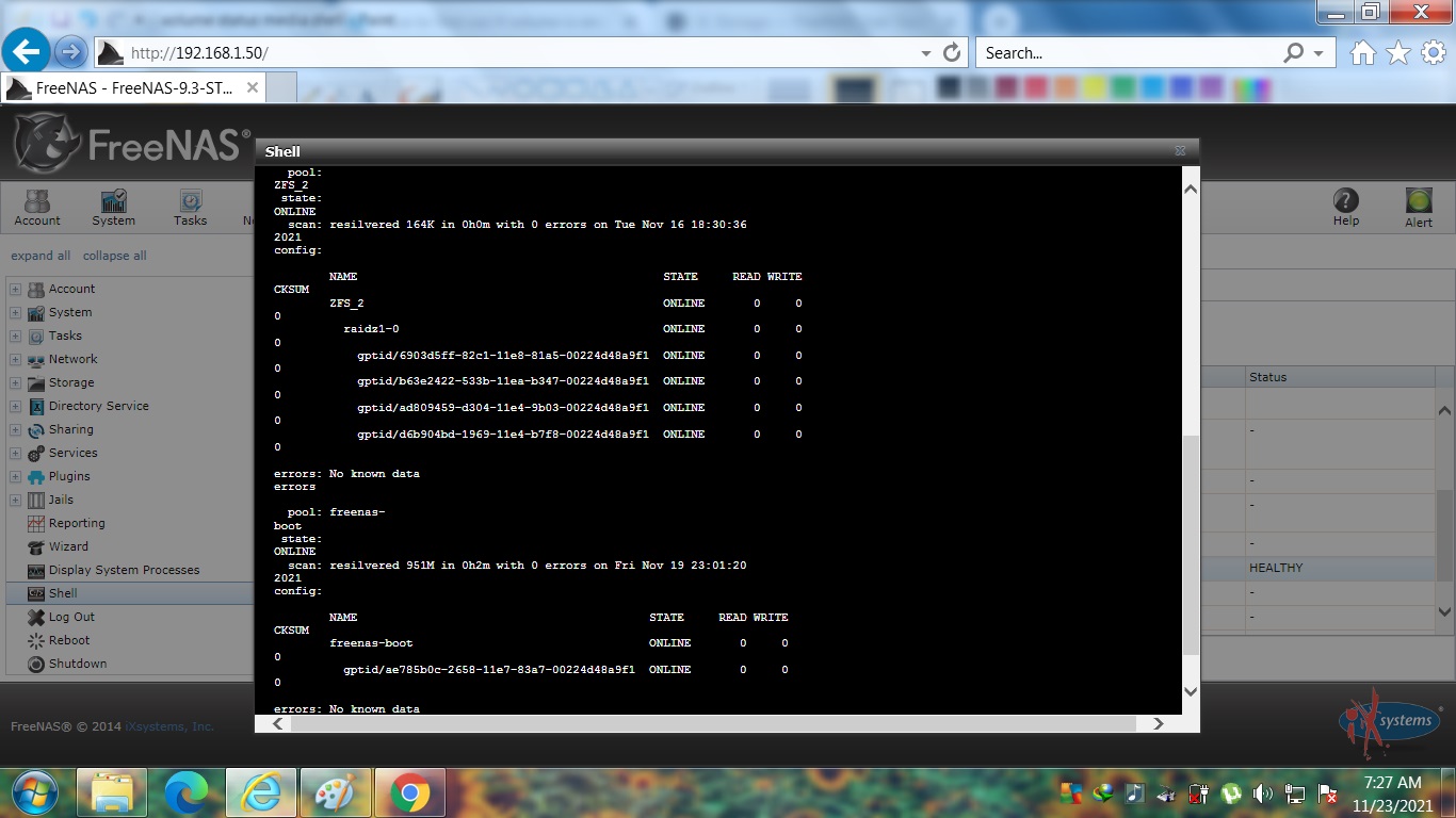

HOW TO FIND OUT IF MY VOLUMES ARE ENCRYPTED .
If you do zpool status do you se the disks in the pool ending with .eli ? if yes, it's GELI encrypted (the only type possible in older versions).

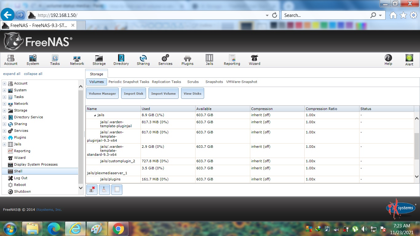

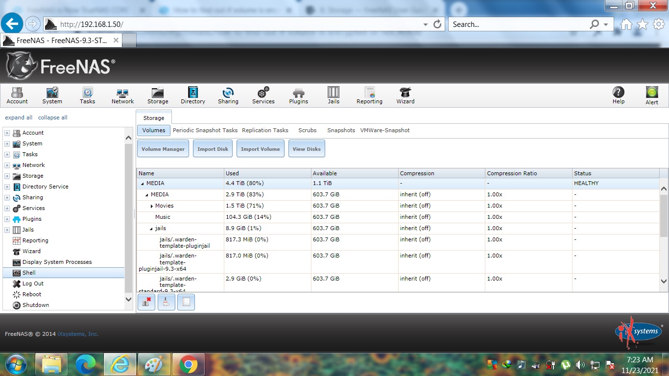

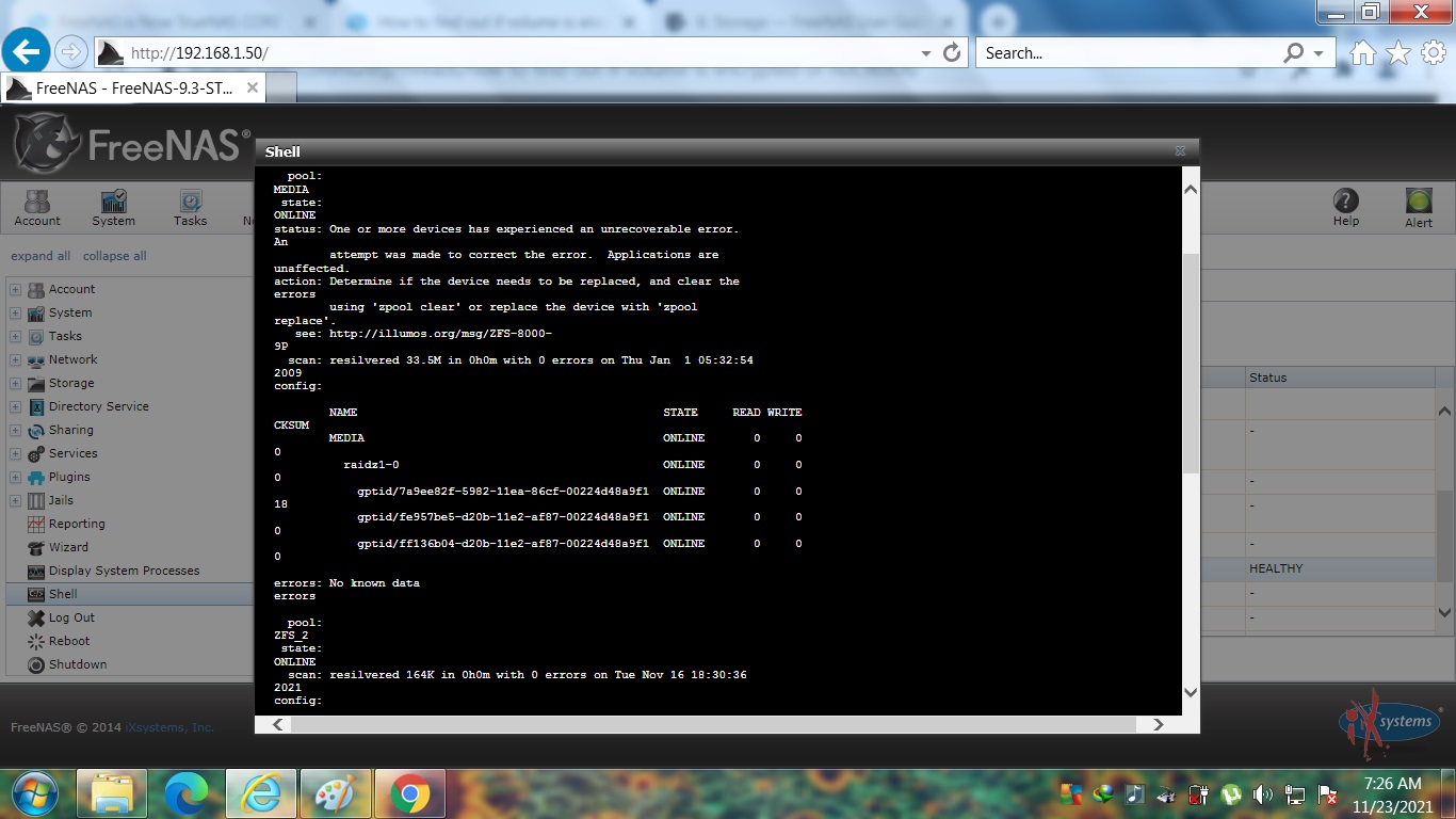

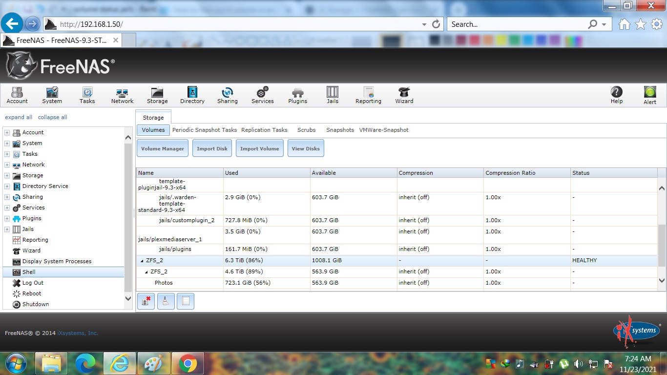

The following are screen shots of gui and shell . looks like my volumes are not encrypted .

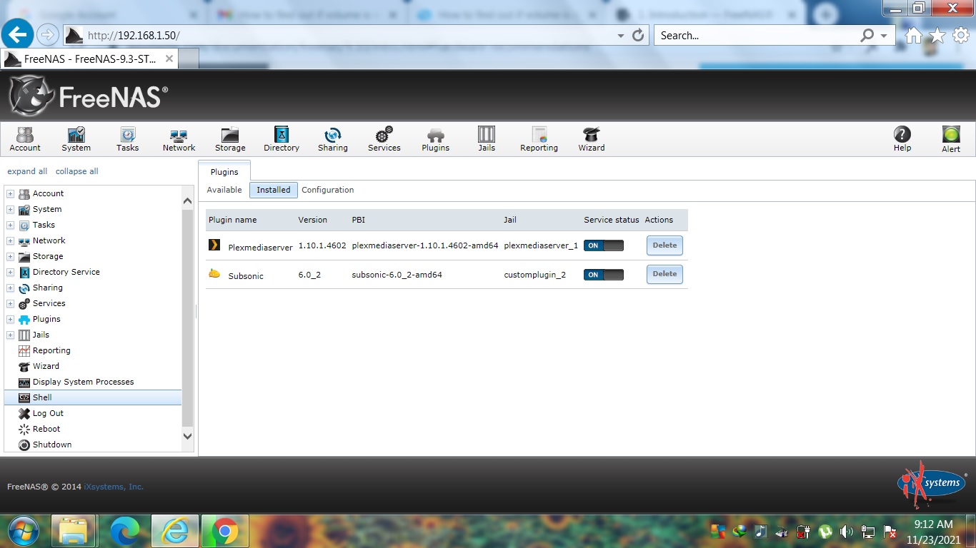

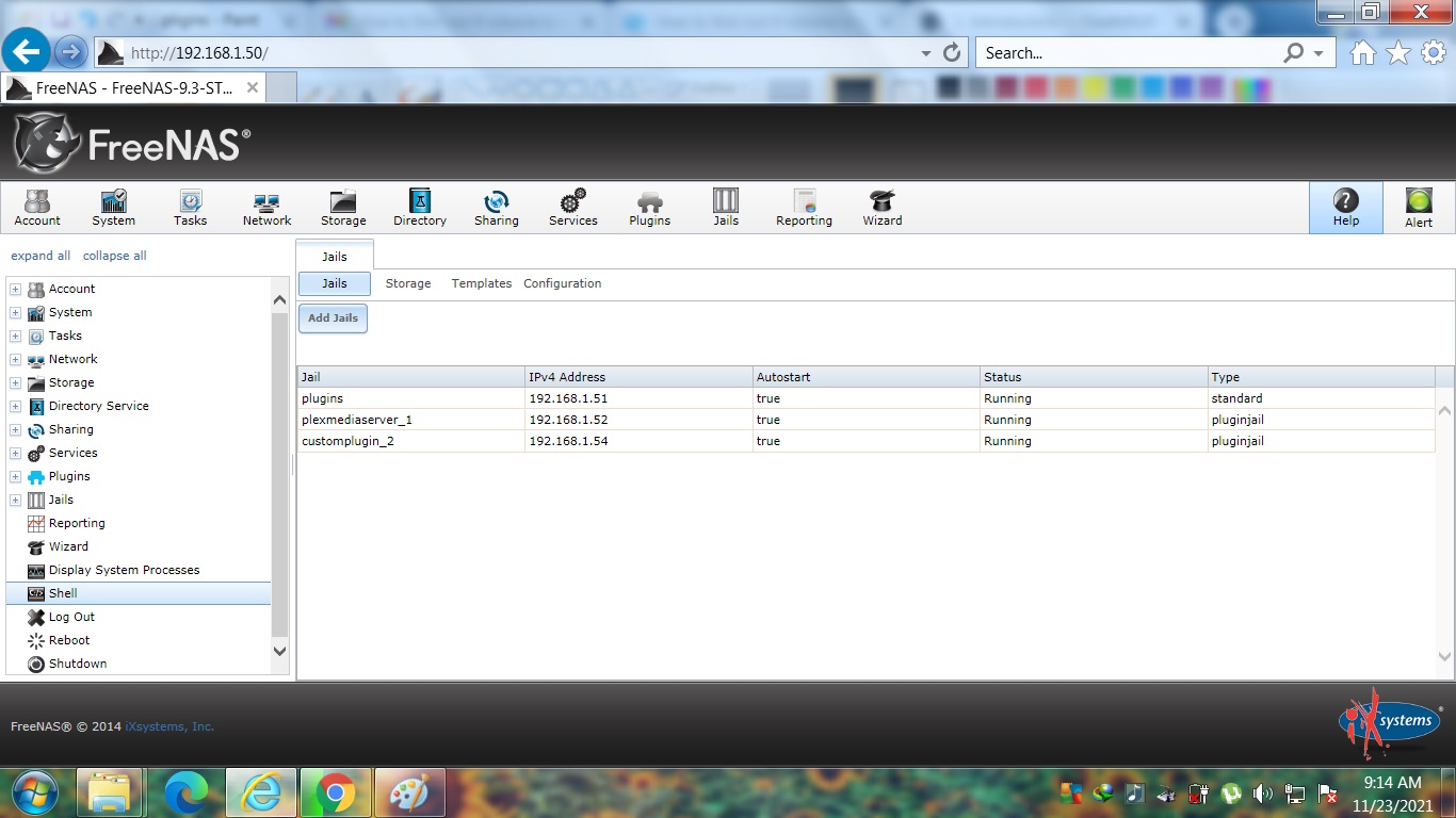

i dont know if my terminology or description is correct . please bear with me.
i currently have two plugins running
1. Plexmedia server
2.Subsonic ( music server , i guess)
Frankly speaking i dont user these services at all , just tried it out initially . I dont mind if i lose my plugins and jails when i upgrade to 9.10 version of freenas.
I use my freenas as a file server and as a backup for my photography.
I use vlc player on my windows and android devices to watch movies n stuff.
QUESTIONS:
1. CAN I DELETE or REMOVE THE PLUGINS AND JAILS BEFORE I UPGRADE TO 9.10. ( IF I CAN ,HOW SHOULD I DO IT )
2. SHOULD I DELETE or REMOVE THE PLUGINS AND JAILS AFTER MY UPGRADE.

If you don't use any jails or plugins, then you can delete them before the upgrade using the blue Delete button next to each jail.
