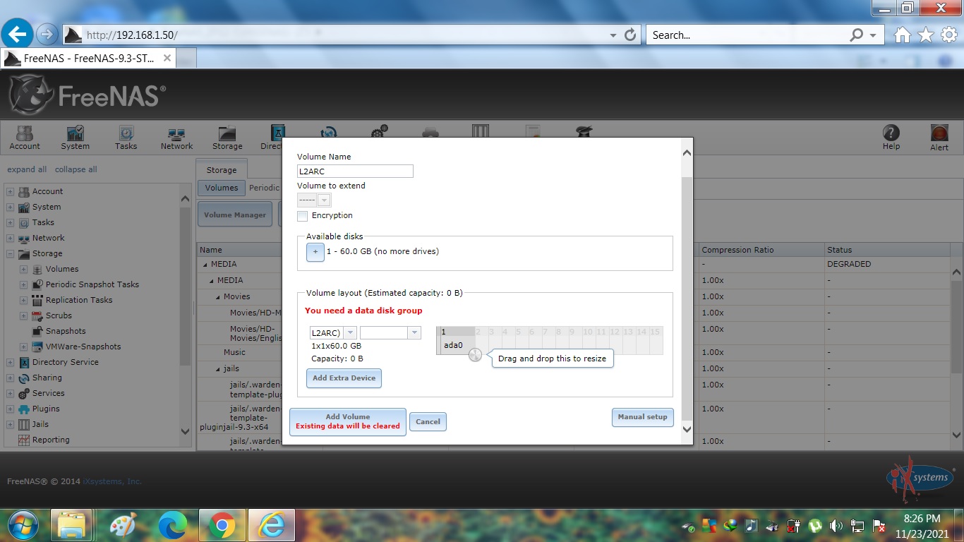

i tried to add L2ARC again but not able to , when using gui , under volume layout it say (
You need a data disk group ).
My 60gb SSD is ada0
GUI screen shot

i tried to add L2ARC again but not able to , when using gui , under volume layout it say ( You need a data disk group ).
My 60gb SSD is ada0
GUI screen shot
You're trying to create a pool with only L2ARC in it... that's not meant to work.
What you want to do is add L2ARC to your existing pool... I can't remember how to do that in the old UI, but I think it's possible... Looking it up here: https://www.ixsystems.com/documentation/freenas/9.3/freenas_storage.html#volume-manager
It seems you need to not specify a name and instead select from the drop-down "Volume to Extend" and then do what you were trying to do (you should also see the existing data VDEV after you do that.
