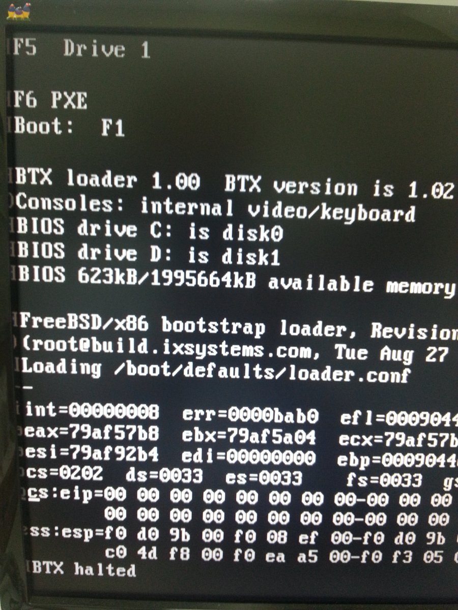

I"m trying to install FreeNAS 9.1 on an HP Microserver Gen8 microSD card. I'm installing through iLO. I can install Ubuntu Linux on this card fine, but trying to install FreeNAS keeps giving me the error in the attached pic. Has anyone seen this or know of a solution?

I wound up booting to a live linux CD, downloading the freenas img file, & dd'ing it directly to the microsd card. Works great now.

I'm not sure about a btx loader issue. I solved my issue by booting the Microserver to a linux livecd, downloading the FreeNAS img file, then dd'ing the img file to the MicroSD card. Directions here: http://doc.freenas.org/index.php/Burning_an_IMG_File

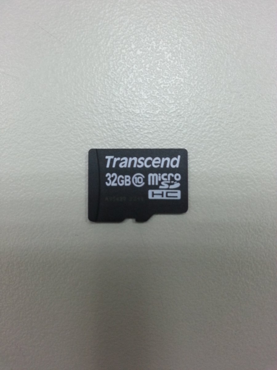

kj_tcm
Oct 8, 2013
Install FreeNAS 9.1.1 x86 on an HP Microserver Gen8 microSD card OK.But reboot are BTX halted.

I have many microSD cards, and none of them worked with FreeNAS as a boot device with any of my converters. My advice would be to get a 4GB+ USB stick.

Yeah, I have two different USB sticks, a SanDisk 16GB microSD and a 16GB transcend microSD. I tried every combination I could think of, and never got the machine to run. Always stopped at the BTX loader. I'm RMA'ing the box and will be posting a message looking for some advice on hardware probably later this evening, or tomorrow, depending on how much of my own research I can do tonight.

had the same issue. Problem is with the HP Sata Controller. Switch it from HP Dynamic Sata Array to Sata AHCI in the BIOS and it will boot fine, (changing that will also wipe any data stored on any harddrives in the machine.
Looks like FreeNas does a check for drives and if it cant find any it just gives up and doesnt boot. a warning message would be nice

The BTX error is related to AHCI mode for sure. I had the same issue until I switched the setting to SATA AHCI. Though I did not lose any data on my drives which were pulled from an ESXi implementation of FreeNAS using VT-d. Data was a copy off my Time Capsule for testing so I wasn't too worried about it.
