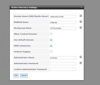

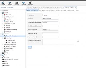

I've read the documentation about FreeNas and Active Directory on page http://doc.freenas.org/index.php/Active_Directory and I've done all configuration correctly (i guess), let me post some STAMP of my freenas conf.
first active directory configuration:
if you cant read -> http://www.dossetti.it/config-AD.png
second, network configuration:
if you cant read -> http://www.dossetti.it/config-network.png
