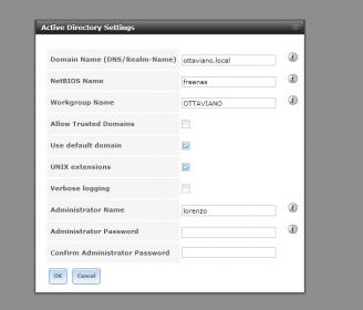

first active directory configuration:
if you cant read -> http://www.dossetti.it/config-AD.png

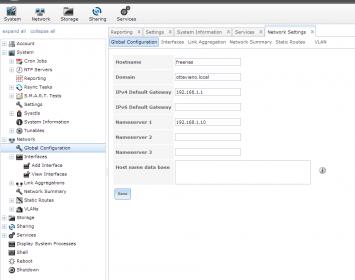

second, network configuration:
if you cant read -> http://www.dossetti.it/config-network.png
