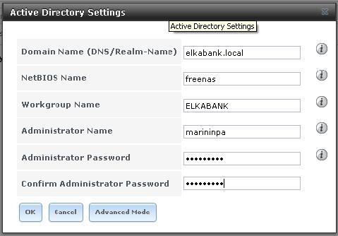

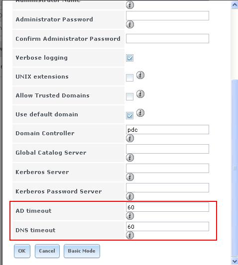

1. I installed Freenas 8.3.1 RC1 and try to join in the AD.
2. Configured AD as the instructions
3. When I turn on the AD service in FreeNas - In the AD the computer account is added, but the service AD does not start.

What am I doing wrong?
