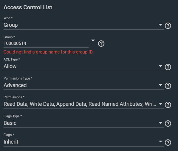

I have two FreeNAS boxes.
Box 1: Virtual on ESXi - purely for testing purposes whilst I work out how things work
Box 2: Hardware. X10SRi-F, 128GB, Boot from SATADOM, Lots of scratch disks for testing with
There are two Windows AD Servers, both virtual, work just fine. LAN is just layer 2 with no known issues
Both on 11.3-U2.1 Built from same ISO
Box 1 works with AD. On a reboot it fails but this is fixed with a couple of POSTINIT commands from elsewhere in this forum
midclt call cache.pop DS_STATE
midclt call directoryservices.get_state
When I set up a windows share I can assign a domain group to it and it works
Box 2: Says its attached to AD and requires the same fix to the reboot issue as above.
wbinfo -u returns a list of domain users
wbinfo -g returns a list of domain groups
wbinfo -t returns succeeded
But when I attempt to assign a group to a share there are no AD groups available in the Group* dropdown box. Just as there are no AD users available if I try and add a user to the ACL. The AD users and groups are no appearing in the GUI
Box 2 does appear in the AD correctly as far as I can tell.
I joined the domain in the following manner:
1. Set up NAS name, and domain, fixed IP address in Network
2. Set up location in System\General
3. Removed the NTP Servers and added my DC's - which are pointed to ntp.org themselves. Time seems correct
4. Setup a pool
5. Under Directory Services\Active Directory put in domain name, username and password and ticked enable
6. Waited a bit for Directory Services Monitor to say "Healthy"
I have spotted other incidences of this issue on the forum - but not seen any solution that seems to apply to me / works as everything I try says its working - except it isn't
I did try setting up a share - so it appears in Windows. I even tried setting permissions on that share - but got told I have no access
