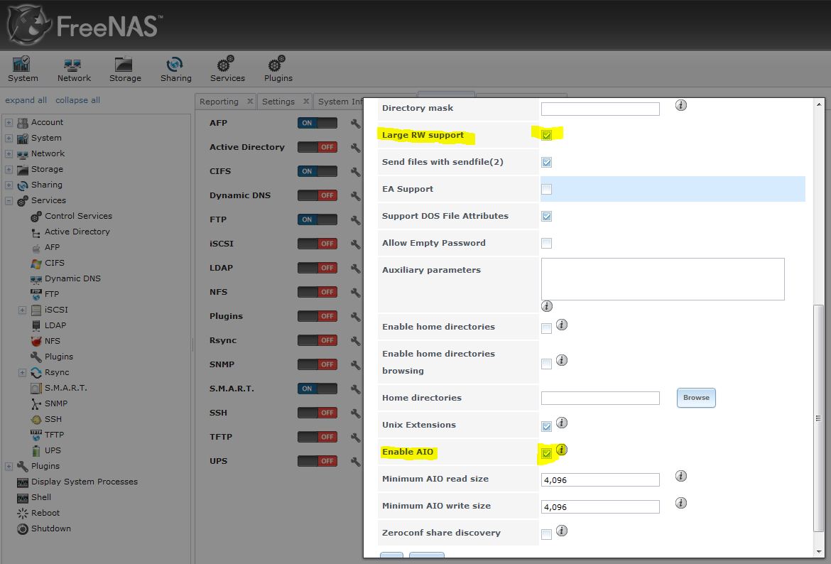

I had the same problem when I did a fresh install of 8.2.0 BETA 2.
What I did to fix it was enable "Large RW Support", and "Enable AIO" under the CIFS settings under services. See attached JPG. I don't know if I just got lucky, but this is what it took for the service to start on my FreeNas.

Hi, I'm having the same issue after making a clean fresh install from 8.0.4-MULTIMEDIA to 8.2.0: This is my "messages"
Mar 22 08:18:56 Odin root: /usr/local/etc/rc.d/smbd: WARNING: failed to start smbd
Mar 22 08:18:56 Odin notifier: /usr/local/etc/rc.d/smbd: WARNING: failed to start smbd
Mar 22 08:18:56 Odin notifier[2069]: Executing: /usr/sbin/service nmbd quietrestart
Mar 22 08:18:56 Odin notifier: nmbd not running? (check /var/run/samba/nmbd.pid).
I have no "/var/run/samba/nmbd.pid" to show though.
I touched NOTHING in the configurations. Either I am unlucky, or cifs doesn't work by default on 8.2.0 ?
Anyways, Brosif_My_Nif's "trick" did the work for me.
