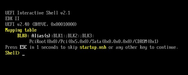

Hi.
I successfully created VM for test with UI, but i can't install OS (Win 7/8.1/10) via VNC. I added ZVOL to DISK and install.ISO to CDROM. I trying both settings for boot UEFI and UEFI-CSM, but i can't boot from ISO. What i must change or set to start normal instalation like from BIOS on VM?
From console:
grep VT-x /var/run/dmesg.boot
VT-x: PAT,HLT,MTF,PAUSE,EPT,UG,VPID is suported
Thanks for help.

I can only confirm for Windows 10 the following method:
Boot Method: UEFI
Devices -> VNC -> Wait to boot: Checked
When you connect via VNC the system will start booting, a message will appear to press any key to install from CD-ROM, if you don't press a key, it will go to the UEFI Shell.
I kept expecting it to boot to CD without any key press when I was doing it. I learnt my lesson about reading the messages displayed on screen.
