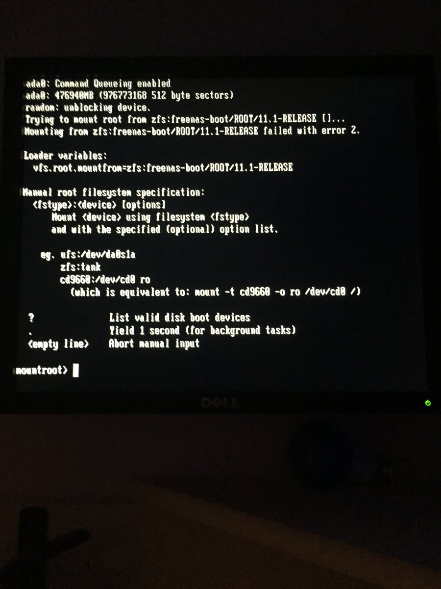

I attempted to auto-update my FreeNAS box this morning and everything went fine until after reboot...
Please help, I know little to nothing in regards to troubleshooting FreeNAS and/or FreeBSD. I've had this server running for a few months now as a platform for Plex.
Please help!

That error typically means the boot device died. You might have to install to a new USB device and restore your (previously saved) config.

Brand new to this forum, didn't realize there was such an extensive guide available. I was able to revert back to the previous 11-U4 environment and all is good now. I have since created a saved clone of this environment just in case. Afterwards I again attempted to auto-update to 11.1 release and the same exact thing occurred after reboot (failed with error 2). I'm just going to stay on U4 since it works fine and is very stable.

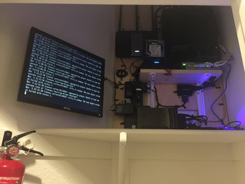

This is my setup...
