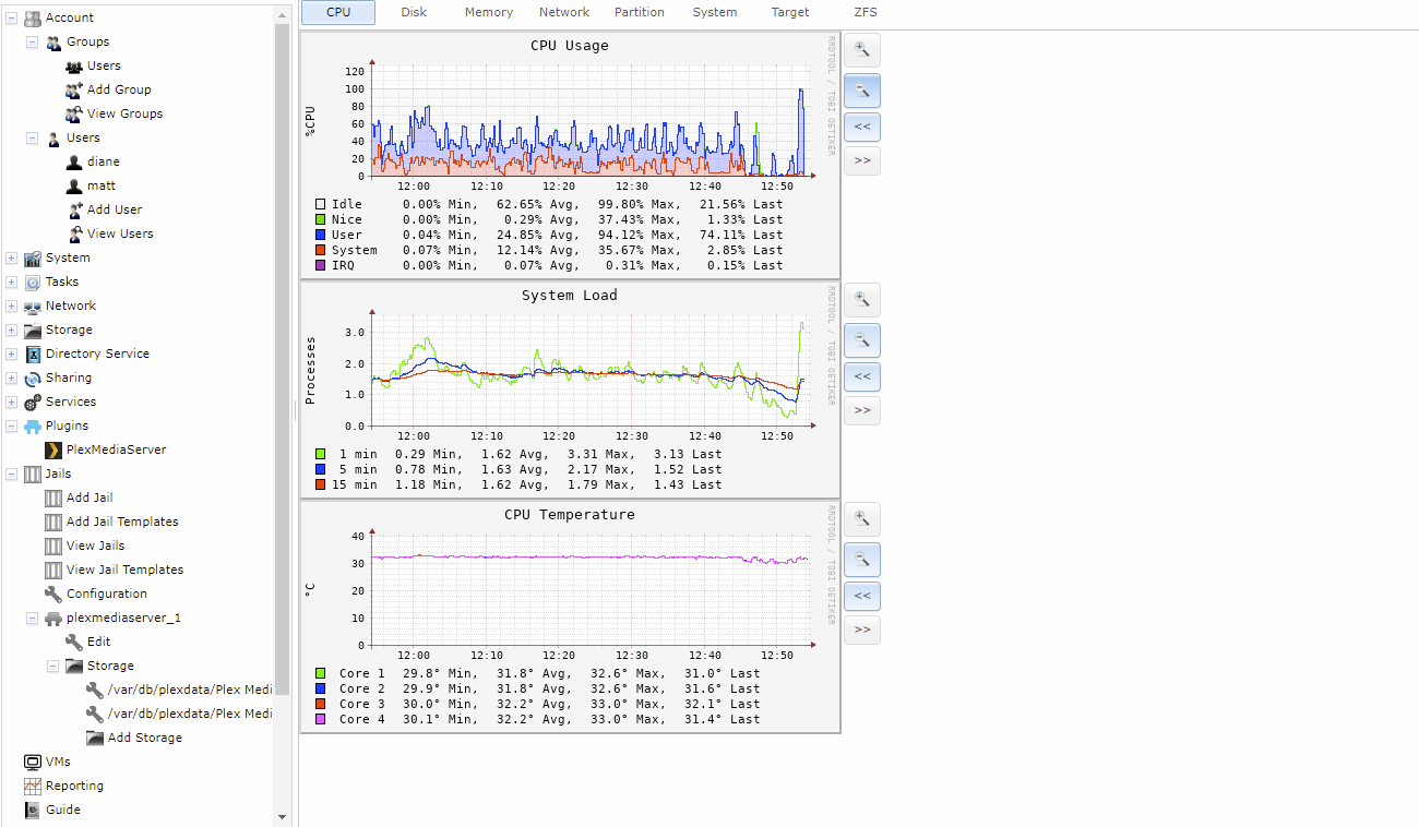

Hi All
Ive installed FreeNAS 11 (dual USB Flash drives) and has the following:
i5 - 3.2GHZ
10GB DDR3 Ram
SSD for jails (aka Plex)
2x 4gb (mirror)
2x3gb (mirror)
Plex plugin installed
I'm constantly seeing high CPU peaks, often from a process called python 3.7
This is when nothin gis happening on the server at all.
The only thing its just for is simple SMB shares (2 users!) and Plex.
Anyone suggest anything, as its killing streaming videos from plex !!
(PS the same machine used to run on windows and plex was great!)

You didn't give enough detail about your hardware. What model i5, there are many and they have been making i5 processors for years.
I wonder if you have enough memory, but let's find out what the CPU is.
I don't know, but it is possible that, the Plex software under Windows was using the video card to do some portion of the encoding. Under FreeNAS, all encode is done by the CPU. That means a more robust CPU may be needed, but FreeNAS almost doesn't use the video card at all. The console only displays text after all...
Anything further would be speculation at this point. You might want to read this though:

That is a LGA1156 socket and there have been quite a bit of architectural improvements since then. If you're on a tight budget and can't get a newer (not brand new) system board, you will probably need to switch to a chip that is quad core.
If you can spend around $250, I can suggest some great used equipment from eBay.
