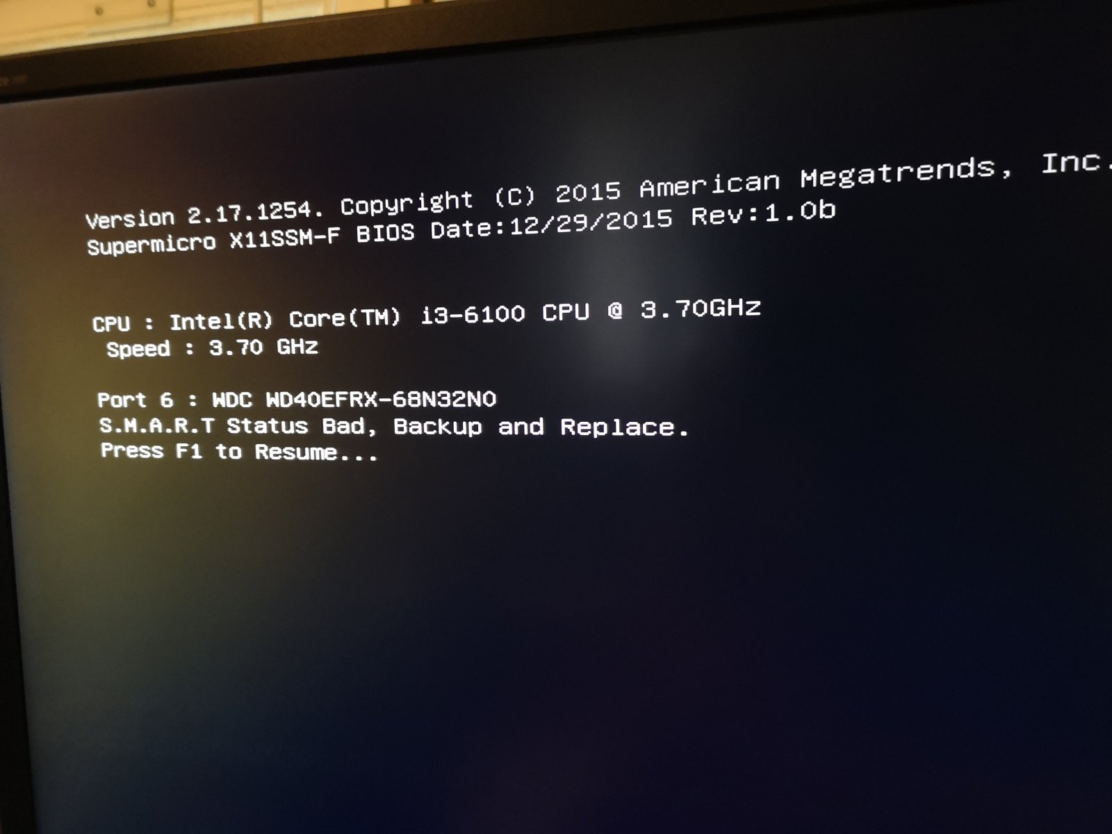

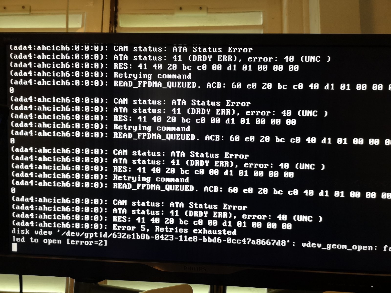

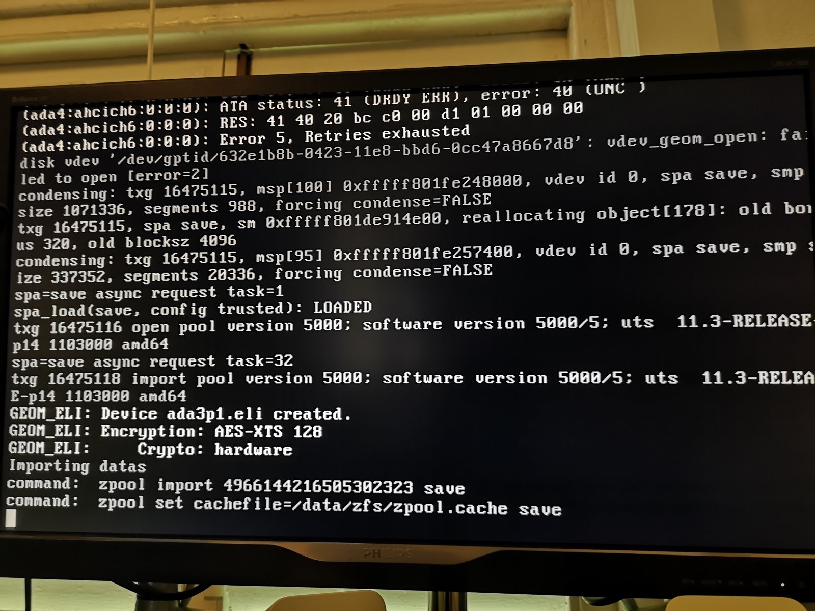

Today I wasn't able to access my freenas UI within the browser like I ususally do. I restarted but still the problem persisted.
When I plugged the monitor to my server I can see a lot of error piling up.
I attached a few pictures so you can see.

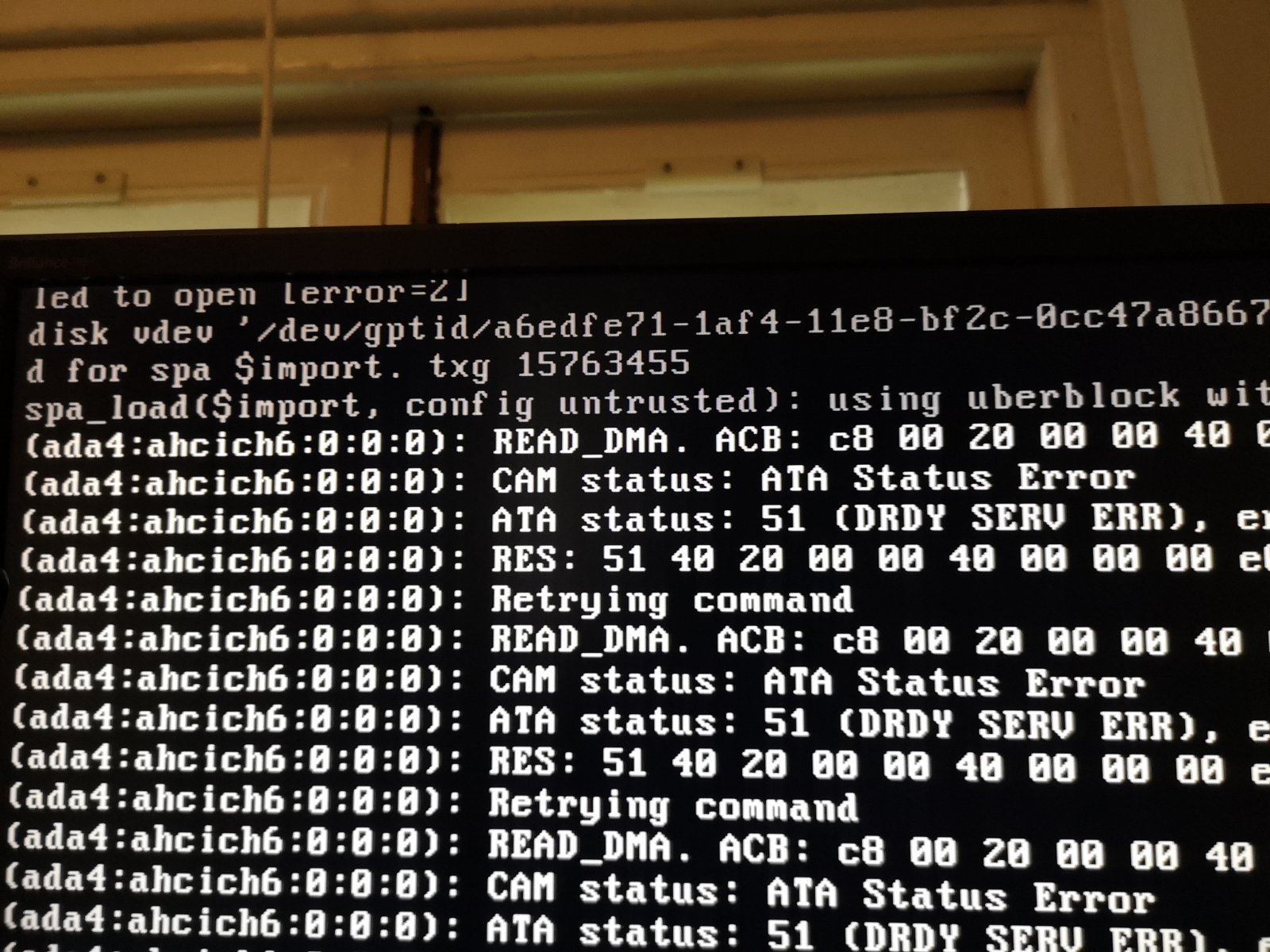

I have tried again today I got this message.
I wonder if I have an hardware issue? Is it secure If I unplug my hard drives one by one and reboot to see if freenas starts?
I can't even access the terminal at the moment so I can't log in single user mode.

Either disable the SMART check in the BIOS or unplug the drive in Port : 6
