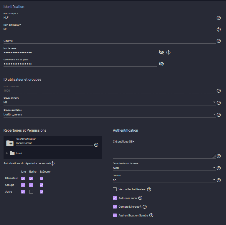

New user, non-root, config:

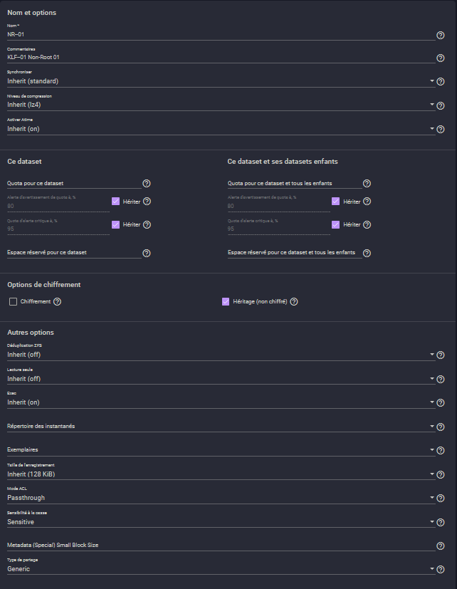

New dataset on my first pool, config:

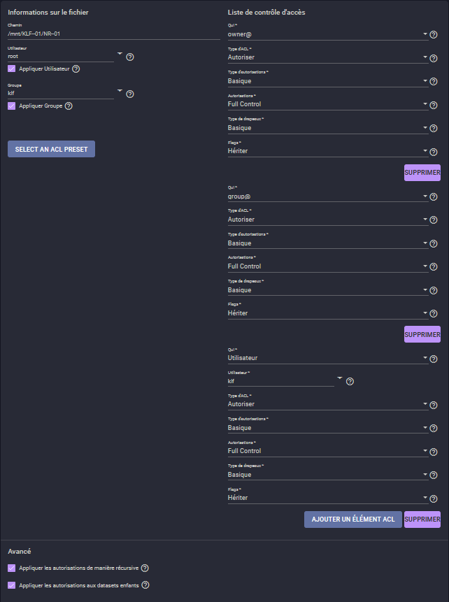

ACL for this newly created dataset, config:

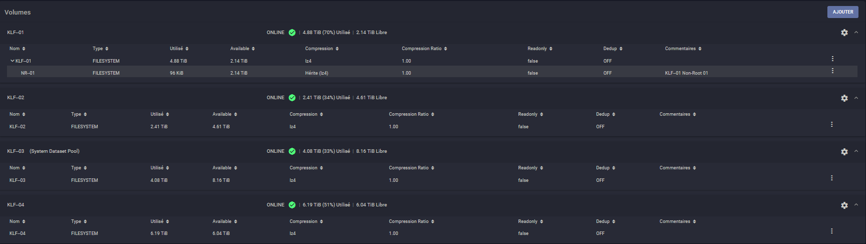

Pools, the first one with the new dataset, overview:

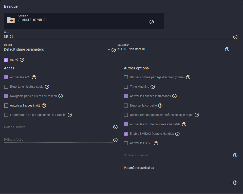

Mount point of this new dataset, config:

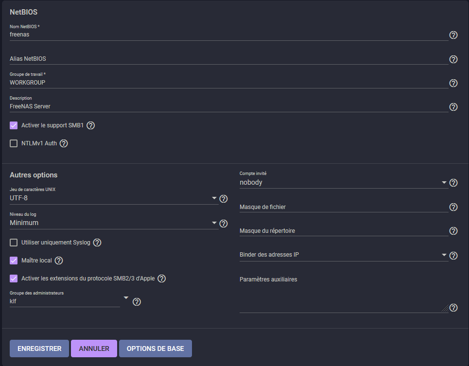

And finally, SMB service config:

morganL
Captain Morgan
Administrator
Mar 10, 2018
2,694
Still inexplicably stuck. Even dropped forced SMB1, nothing better.
If it can help to understand where's the issue, here is how Windows 10 reacts:
FreeNAS appears in my network: double-click --> pop-up connection window --> klf (new user) + password --> I can "enter" FreeNAS and see mounting points, including NR--01 (THE dataset linked to the new user klf) --> pop-up error message: "Windows can't access to 192.168.x.xxx\NR--01..."
Please??
"root" is still in the ACL of the newly created dataset... isn't that what you are removing?
