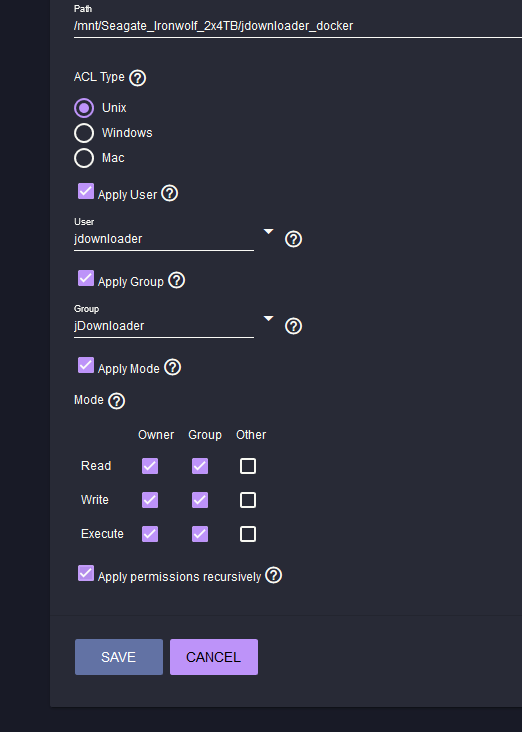

That was the way I tried to get the stuff working:
I created Datasets on root - like this and created users and groups for each dataset:
root@freenas[/mnt/Seagate_Ironwolf_2x4TB]# ls -l
total 44
drwxrwxr-x+ 3 tower_ad     users        5 Dec  2 23:44 Dokumente
drwxr-xr-x  3 root         wheel        4 Nov 24 19:30 iocage
drwxrwx---  4 jdownloader  jDownloader  4 Dec 10 01:09 jdownloader_docker
drwxr-xr-x  2 root         wheel        3 Nov 24 18:09 music
drwxrwx---+ 3 openVPN      openVPN      3 Dec 10 00:59 openvpn
drwxrwxr-x+ 4 root         wheel        7 Dec  1 22:58 photo
drwxrwxr-x+ 5 rancher      rancher      6 Dec 10 00:51 rancher_OS
drwxr-xr-x  2 root         wheel        3 Nov 24 18:10 video
ACL Types etc I did like this:

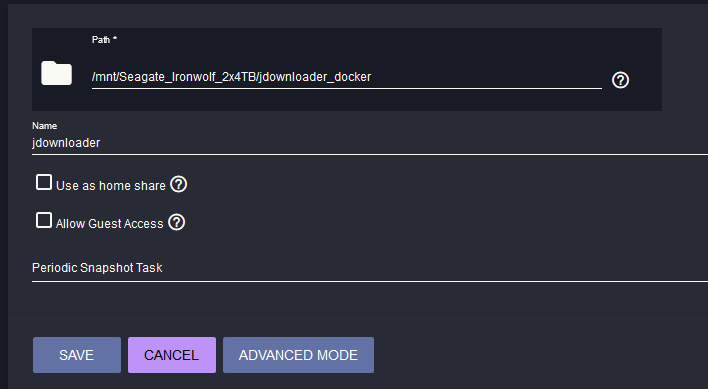

SMB-Shares were configured like this:

You're setting 774 permissions, so when the userID doesn't match, there's no access.
You should be able to sudo chown the directories in the container to the user that is running the services.
(or you could just tick all the boxes ...777)
