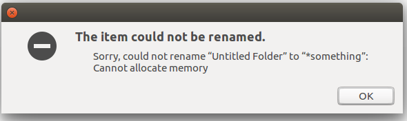

I've tried creating new folders on the SMB shares on Ubuntu which start with an asterisk, but it gives the following error: 'The item could not be renamed. Sorry, could not rename "Untitled Folder" to "*something": Cannot allocate memory'

Any ideas as to what has happened?
Has the folder disappeared into the ether, or is there a way of getting it back?
Is there a way of avoiding this in the future? Would be ideal if people are safe to name files and folders whatever they'd like (within reason obviously)
