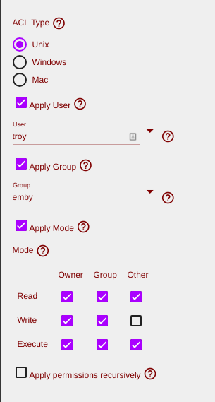

I would first create the group emby and set group id to 989 also I would add myself as a user to this group.
Next I set the group of /mnt/tank/media to emby and check the box allowing rw permissions for the group.
This dataset will be added as storage inside the jail. This is the only configure on FreeNAS I do for the user that will exist inside the jail.
When I install Emby, the plugin script creates the jail and the emby user and group inside. I add /mnt/tank/media as storage inside the jail. Now since the group emby exists both on FreeNAS + inside the jail and the group has rw permissions we have our common point. Kinda general but hopefully gets you started.
