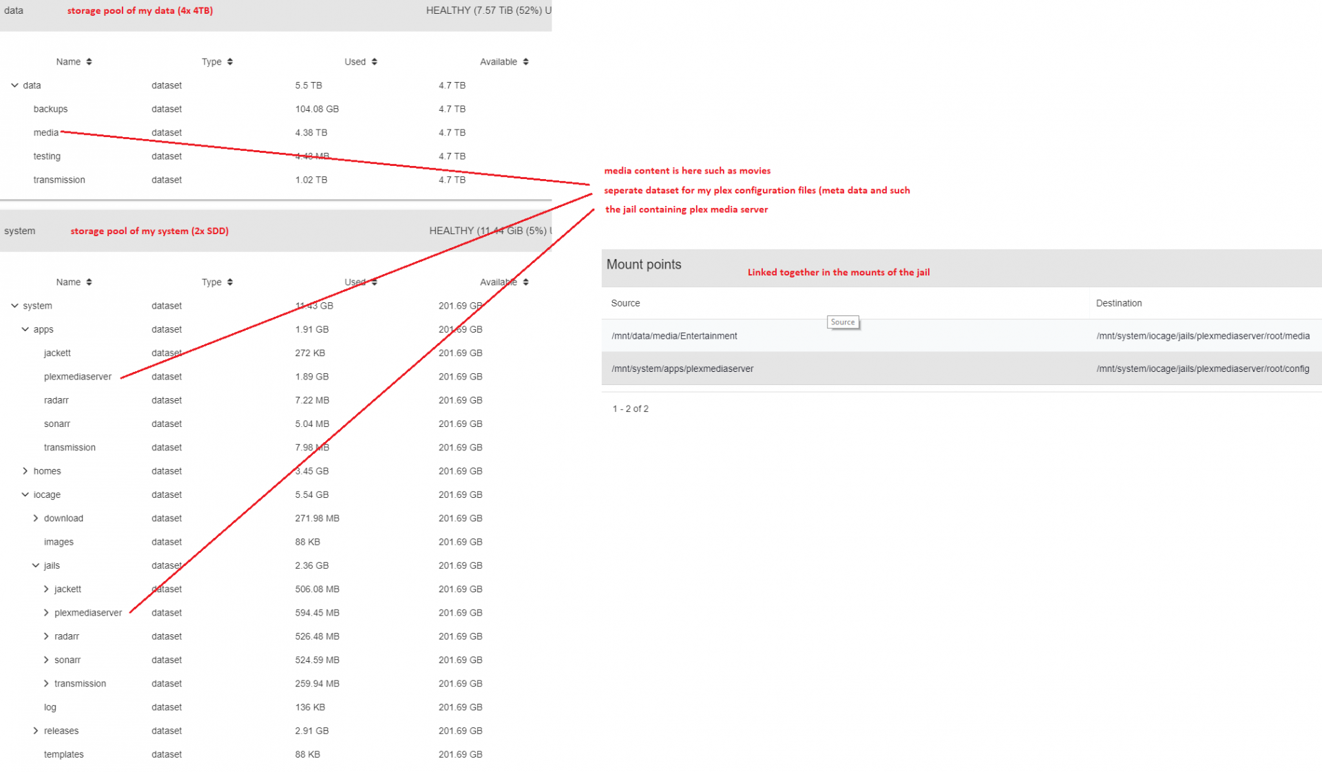

You have to assign a dataset to be used for the jail system. Inside this data set a whole bunch of other datasets will be created including one for each of your jails you create. You're not supposed to store any actual content inside the jail. You have a separate dataset for your movies. Then you create a link to that dataset inside your jail. You can do this through the GUI.
For example lets say you have dataset for your movies calledtank/movies
which is accesable through/mnt/tank/movies
on your FreeNAS server. After creating your Plex jail you can mount that dataset inside the jail at/media
. So when you are inside the jail you will see the movies in/media

You can use the same storage pool for both your jail storage (your Plex instance) and your media content. You just don't want to actually store your content inside the jail but rather tie the media content dataset to the Plex jail so Plex has access to the media content.

Yeah, you reading it wrong. The datasets can be on the same storage pool. This is my setup as explained above with my different pools. I have a separate pool for my system dataset but you can have it all on one pool

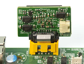

I like the idea of the DOM (Disk on Module) but I think they are on the expensive side, so I usually suggest a regular, small capacity, SSD because it is more economical. Particularly if you are able to take advantage of quality used parts. The last time I built a new system for myself, I used a mirrored pair of 2.5" laptop style spinning disks in 40GB capacity. They have been working great for over two years now.Your board of choice supports Supermicro SATA DOM and @Chris Moore seems to be a big fan of that for the OS
https://www.supermicro.com/products/nfo/SATADOM.cfm
Otherwise just get a good small sized SSD

If you wanted to spend for that, this should be fine:Your board of choice supports Supermicro SATA DOM

The Supermicro SATA DOM (SuperDOM) has some reliability advantages, in my experience. Other brands, usually the very cheap ones, are not very reliable but the SuperDOM devices are pretty decent. I have not seen one go bad, but I have seen other brands go bad. Your mileage may vary.
The two yellow SATA ports on the system board are special in that they supply power so that you can use a SuperDOM in each of those two ports without any need for additional power connections. That is what you were being told here:
https://www.newegg.com/Product/Prod...dom-_-9SIA5EM56D9416-_-2&Description=superdom
