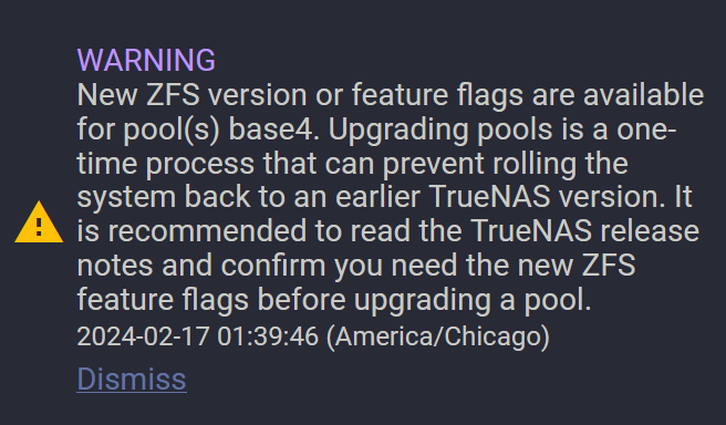

I did notice this message in my alert list but the system has been up for a month or so and I havent run an update since december.
I think this pool does date back to freenas, could it be a version problem?
This message can be ignored unless you know that you want the new feature flags. As it says it's a one time process you can't revert then. Don't try to upgrade (although it probably isn't possible currently anyway) before you fixed your pool.
paleheart
Feb 17, 2024
7
yeah the base4 pool (the internal one) only appears on the import list so isnt an eligible target. I just noted it because the message appears to be from after the power off, like truenas is still looking for the pool, seeing it, then bailing.
It just made me wonder if truenas wasnt seeing the mismatch and preventing the pool from starting.

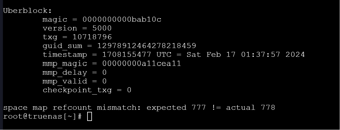

so reading around a little more I found where I could get info on the last transaction which i think shows the error.
Since at this point im just trying to get my data off before i blow this pool away and start over could I roll back to an earlier transaction?

so poking around a little more (im trying not to be too hasty and jump to something that will hose things up worse) I noticed that importing in readonly is supposed to skip a few checks and low and behold doing an import with readonly=on seems to have mounted the pool.
the file list looks right in the terminal so im going to see if i can copy my data out before I try anything more drastic
