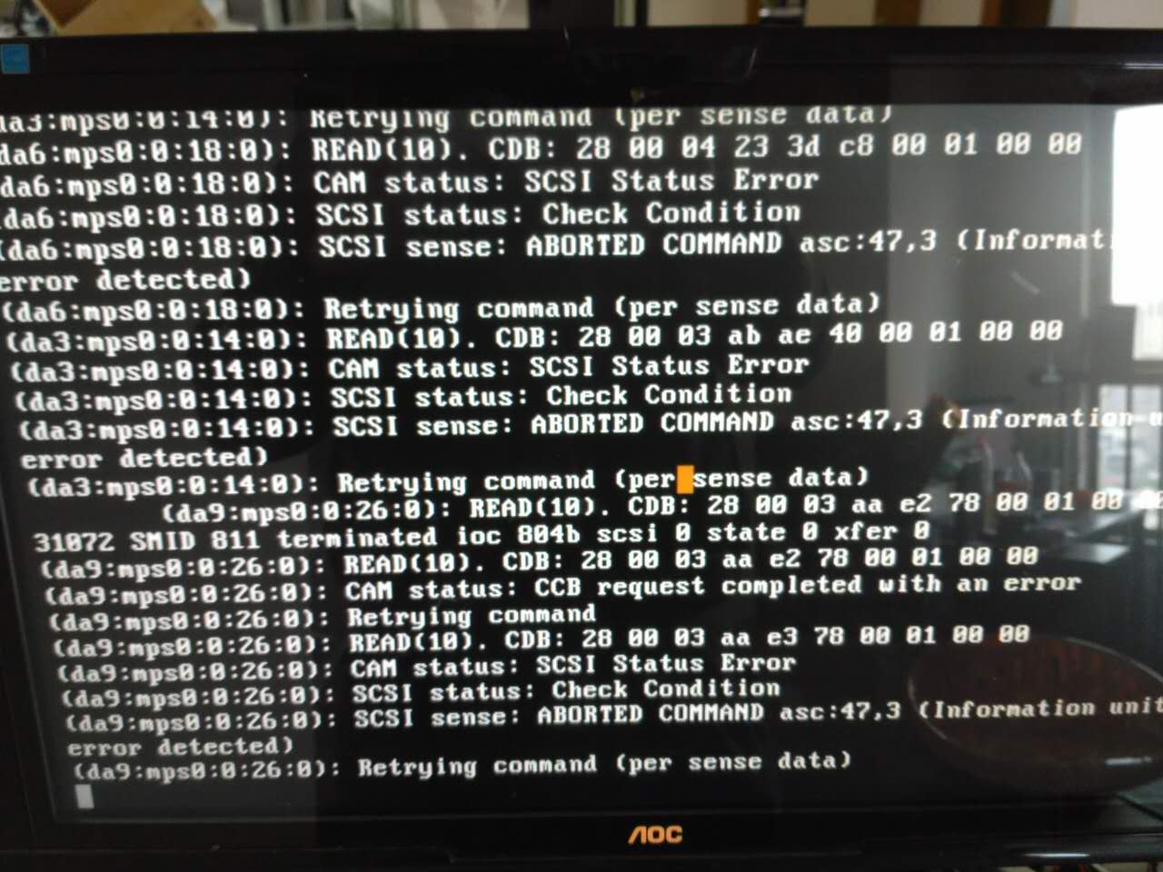

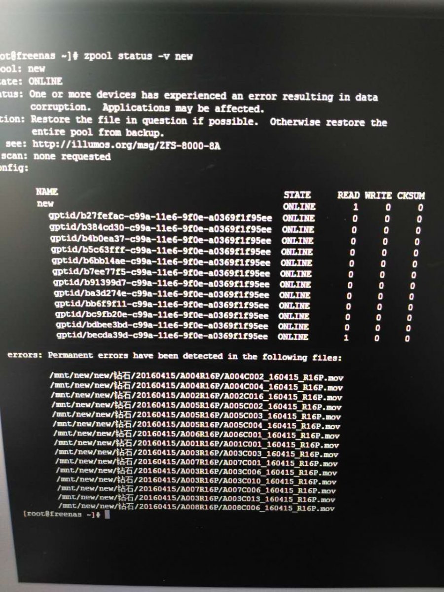

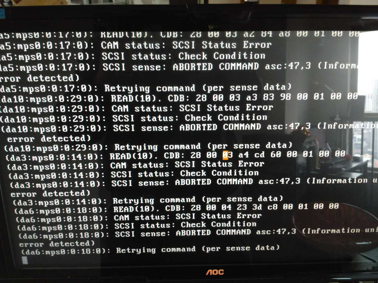

The problem is : When I transfer data from server to client, some errors show me like the pictures in the attachments. But working good from client to server.

Ah, good catch. I guess I didn't look at the left side of screenshot 2 and 3.

thank you all friends.i think its abot the chassis back pannel controller. because i took 8hdds out of box and link direct to 9211hba and try but nothing bad happen. the chassis include one lsi 2x28 expander chipset,i will try to replace the backpannel or the sas cable.
