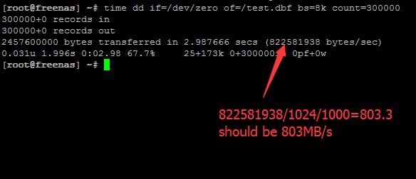

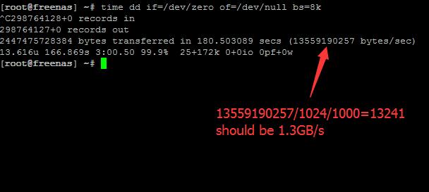

Hi Snaptec. Here is the results of write and read performace, but I used dd command because I dont know how to use iperf but I think its same:),please check the attatchment pictures
PS:
444 is write performance
555 if read performance

SweetAndLow
Sweet'NASty
Nov 6, 2013
6,421
You are running your dd tests against your boot device. You need to run it on your pool and a dataset with no compression. You also need to test using iperf to check your network connection.
snaptec
Nov 30, 2015
502
Dd is local. Iperf is for testing the network line speed
Anyway 2,9 sec dd time is way too short And not a good way to measure speed on a zfs system.
Please read some how to's and do an iperf test over some minutes
Gesendet von iPhone mit Tapatalk

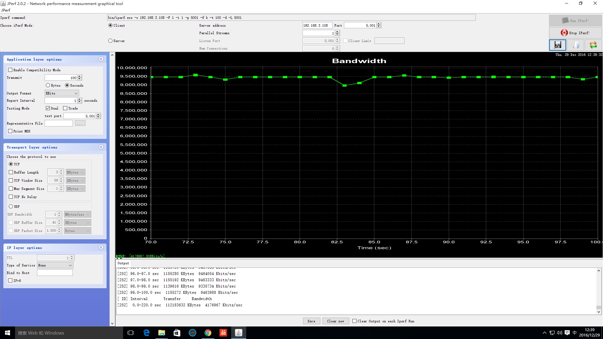

skyyxy
Jul 16, 2016
136
This is the result of jperf, please check it :) thanks
SweetAndLow
Sweet'NASty
Nov 6, 2013
6,421
Looks like 4gbps which is way less than 10gbps.
