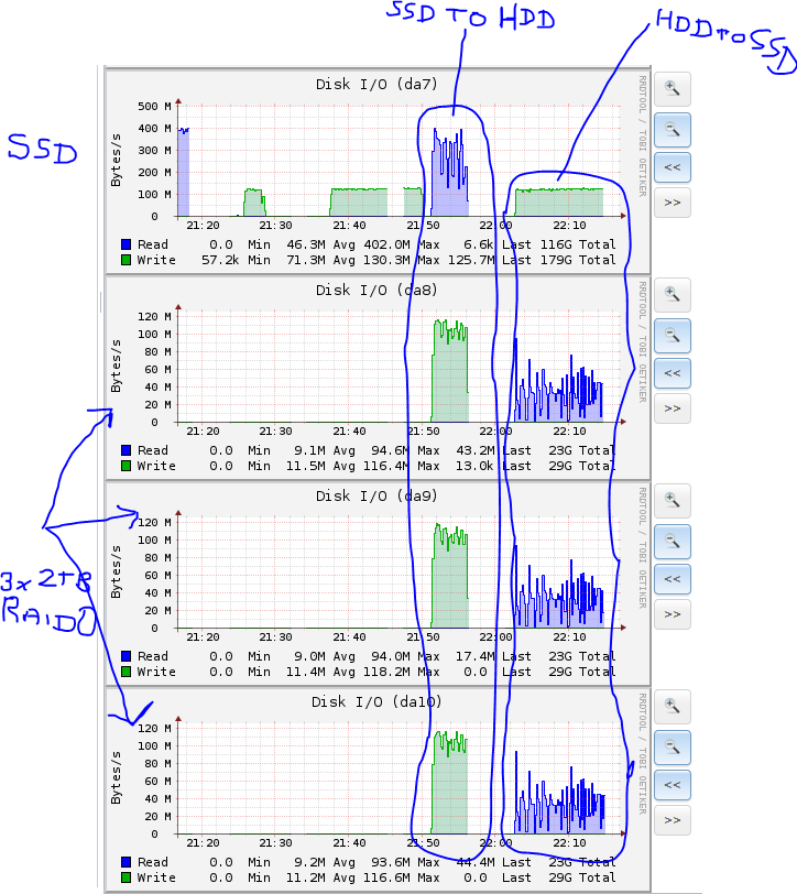

I tried every combination , but I can find why I am getting Very fast Write speed and Very slow on read. I tried every Raid setup and copy over the network but to simplify my test and possible network or Raidz overhead I just created 2 pools ans start copy file between then with ssh and cp command.
Pool 1 is SSD single vdev and another pool 3x2tb hdd in RAID0(stripe).
As you can see on the picture when I copy from SSD to HDD ( RAID0) it's fine all hdd are writing with their max speed(over 110mb/s each) , but after the when I send files from HDD ( raid0) to the SSD they can only provide (35mb/s each) struggling. These HDD are capable of read/write over 110mb/s combine they should provide stream of around 300mb/s
Any ideas will be appreciated , I tried everything I can think of.
P.S. All files in copying process are large 3-8gb mkv files of total around 90GB to make sure the cache was flushed.

SweetAndLow
Sweet'NASty
Nov 6, 2013
6,421
See how when you are writing to the ssd it's very consistent. That means you have a bottle neck there. I think you have found thewwrite speed of your ssd. Which would look like slow reads from your stripped pool. If you want to get a simple idea if performance use dd to write directly to disk from Dev/zero or read from disk to Dev/null.This will get you much better results. PPerformance is hard and had lots of variables.
Nov 11, 2014
1,174
I am not sure where is the bottleneck , my ssd can do 500/mb/s Read or Write. 3x2tb in raid0 should provide 3 time the speed , not barely make speed of single drive. Something is not right here despite my efforts.

1,174
OMG. You are absolutely right. I don't believe this. I guess my SSD can do 500 read and write only on synthetic bench , like ATTO which I often use even now as we speak. I will use mechanical HDD pool of few hdd in raid0 to test other pools speed by copying files between them. I don't trust these synthetic test commands like dd Dev/zero. By the way at least read can do close to 500mb. How could I been so stupid. Thanks a lot again, can I ask you what you are getting from your pool (5x 3TB WD30EFRX RED (RAIDZ2 setup)) for read/write mb/s ?

1,174
Thanks you very much for explaining. I the compression is what made me gave up the first time , it gave me some 5000 mb/s unreal results and the file was not even registered to exist on the disk , despite was big file it made. I turn off the compression and now the results are much different. Now it shows that my SSD can Write 407mb/s and Read: 450 mb/s.
I will agree on the read results , but I disagree on the Write results. As you can see from above posts it turns my ssd can Write about 130mb/s. not over 400 mb/s as I also believed based on my previous test with this drive in Windows with ATTO.
So why the write results are not accurate ?

Nov 11, 2014
1,174
I ran dd if=/dev/zero of=/mnt/ssdpool/fileto.data bs=1024k count=84k and then read the file and it's showing Write 407mb/s and Read: 450 mb/s.
But,
When I copy 87gb of large files from HDD (Raid0 with 3 drives) to the SSD with cp command in Shell then the SDD showed it's true colors : which was Write: 130mb/s.
Steady stream which seems it's the max capability of the drive. I guess that's real life performance , because on the test with dd command was showing 407mb/s which wasn't real. I think has something to do with SSD internal cache or something. When I test the drive in Windows with ATTO Benchmark it did show around 500mb/s read and Write , for smaller files it might be true , but you can't fill the drive capacity sustaining that speed.
Manufactures are deceiving us with high Read/Write speeds which are not sustainable , at least not Write speed in my case.
