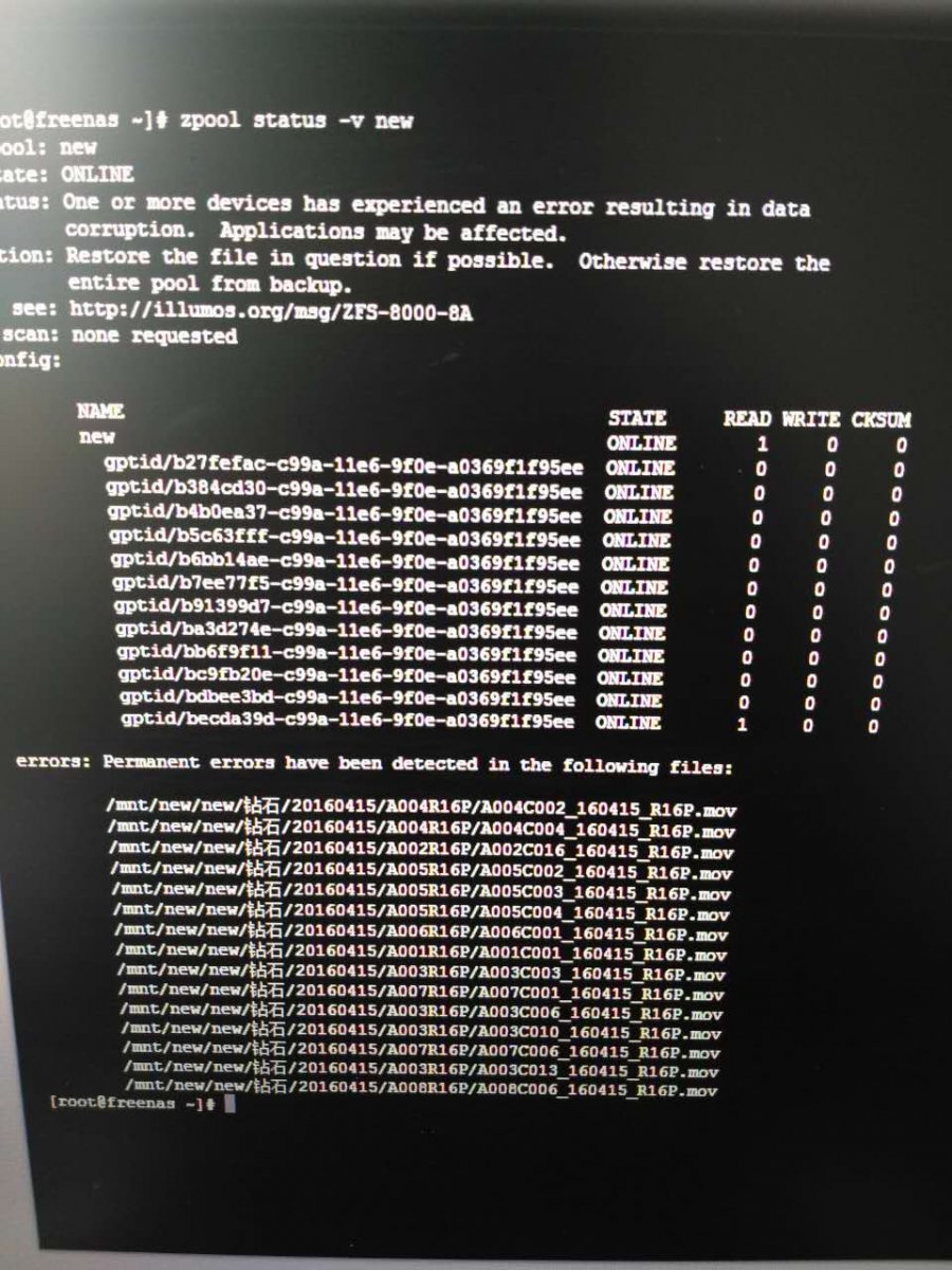

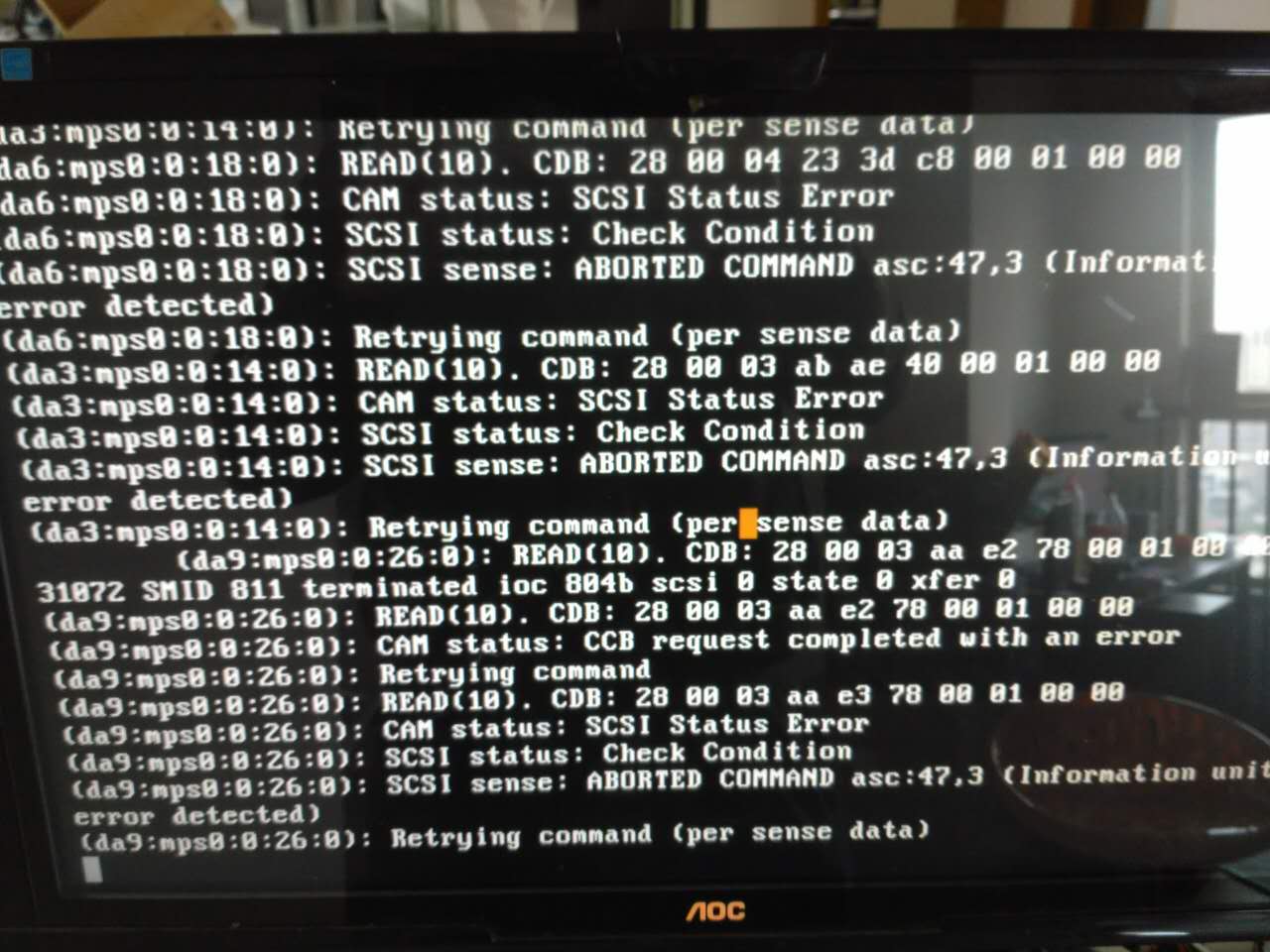

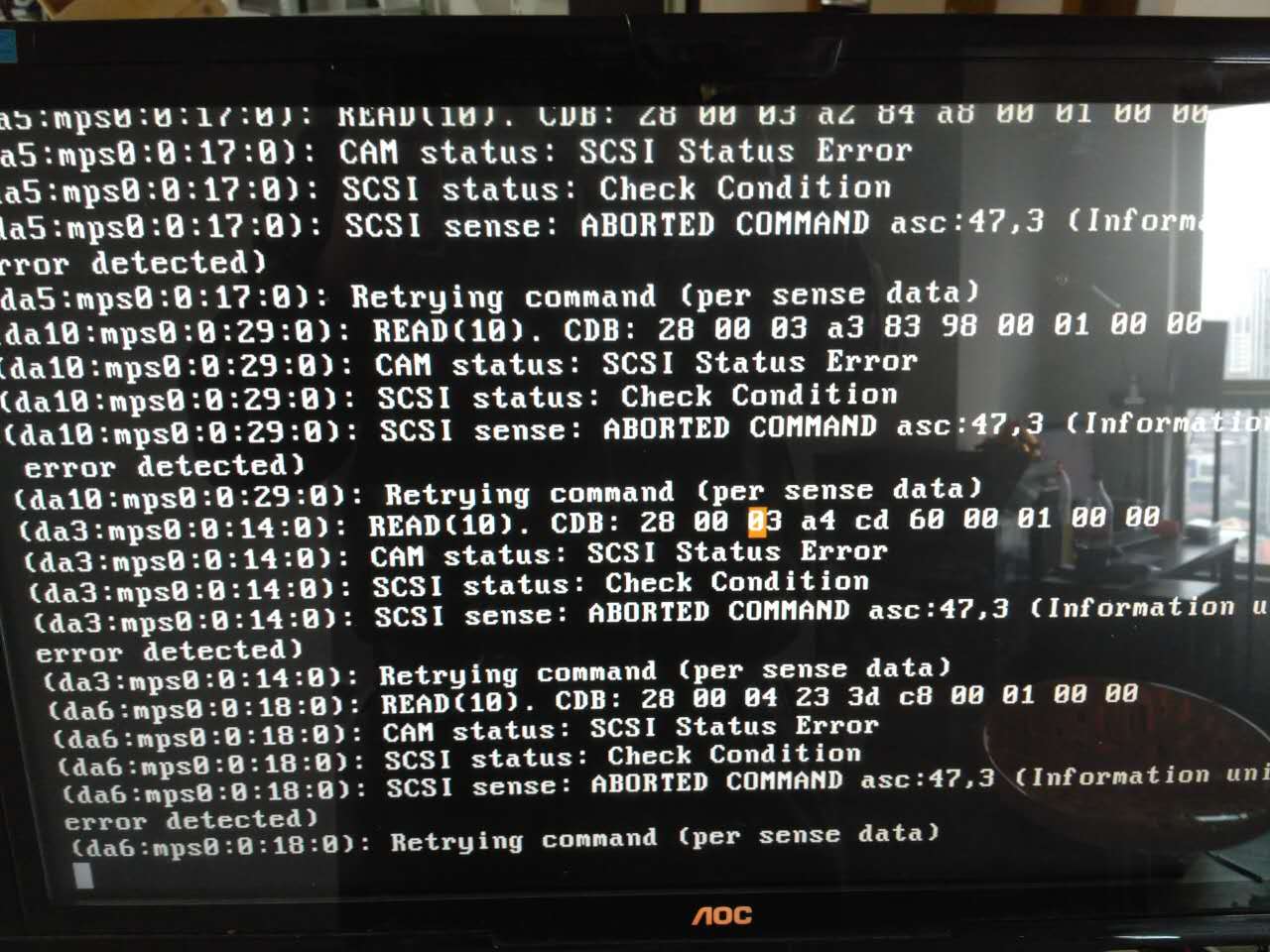

Hi all, Merry Xmas:) I have a new problem. When I transfer data from server to clients the freenas alert me the errors like the pictures in the attachments, then the copy speed will rise down to 0mb/s or very slow , then few seconds later will up again to normal 900-1000mb/s. Anybody can help? Thanks a lot.

SweetAndLow
Sweet'NASty
Nov 6, 2013
6,421
What chassis do you have? Something is still messed up between your disks and controller.
