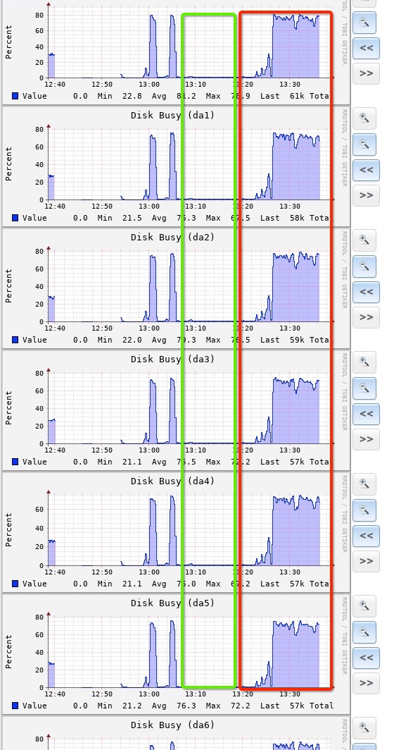

Im using adobe pr ae and davinci resolve under the mac osx and connect the server with afp. When I read files or clips and import to applications is great and working smooth. But when I write files to datazpool that the disks usage is very high(80% for Desktop HDD Zpool, and 40-50% for EXOS Enterprise HDD). Other workstations will very slow in PR AE and Davinci resolve Playback at this momt. Even I setup 1 nvme 1TB for zil (without zil before just use it today), But just read just less than 10% usage. I have no idea why isit. Anybody can help me? Thanks a lot.
In the pictuure the Red is Write, Green is read.
What is the problem? When you write to the disks, the usage SHOULD be high, that means the disks are doing the work you have asked them to do...
Are you not getting the speeds you expect? I think you can find a different graph that will show the actual write speed in megabytes per second instead of as a 'busy %'.
It may be possible you are seeing a lot of 'read-modify-write' or something if the recordsize of your data set doesn't match up with what the application is doing, but I wouldn't jump to that conclusion right away.
thanks for your reply. How I can to fix it? Because when somebody write something to the Server (like copy something or export a clip in Adobe PR) , other workstations will very slow (do something like playback in Adobe PR or Davinci resolve). Or I need use an RaidCard like LSI 9260-8I and SSD as a L2arc to instead of the HBA (now is LSI 9211-8i), thanks a lot.
