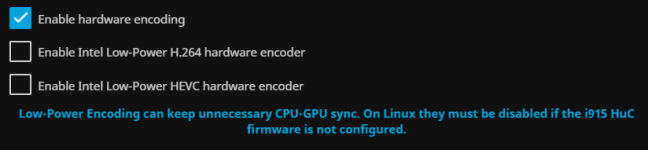

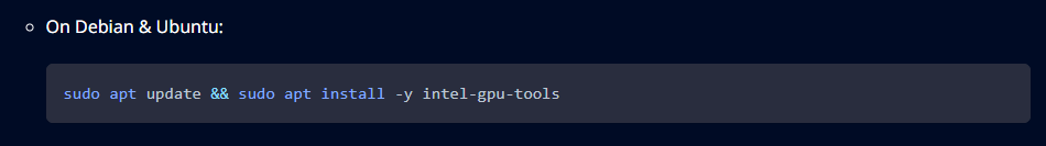

The feature is already in jellyfin as an option to be enabled. And it's also supported by Debain Kernel. But to be able to install it you need to be able to run a sudo apt update and sudo apt install command. And we are not allowed to run the apt commands in the TrueNAS terminal making us unable to install the required software. When enabling it in the Jellyfin app without the required package installed it will result in an error saying that it is not able to transcode the video file. This could be fix by adding the package to TrueNAS as default.
The intel-gpu-tools package isn't required. Just set the GuC boot parameter with the below and you're all set, presuming you're using the jellyfin app from either TrueNAS or TrueChart's catalog.

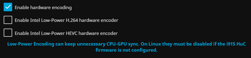

sudo midclt call system.advanced.update '{"kernel_extra_options": "i915.enable_guc=3"}'
Couldent get it to work on Bluefin or the beta of Cobia but on the release build it just worked after i gave it a shoot and enabled it in Jellyfin.
