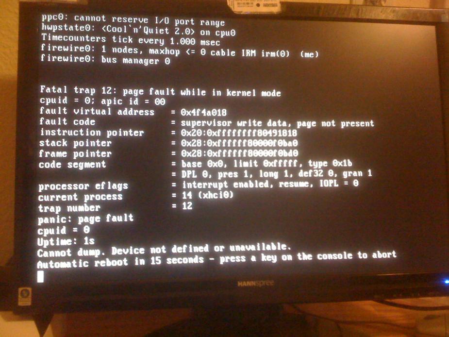

Just installed 8.0.1 on my 160gb drive, boots into disc fine and am able to install Freenas. Upon bootup of fresh install I keep getting this error *See Attachment*
Any help or steering in the right direction would be great, do to this being my first real time using freenas.

Did you do a search for 'fatal trap 12' here in the forums? There can be a lot of reasons this can happen, there are some solutions in those threads. One of them involves a unloading/renaming a kernel module called 'xhci.ko', but only one of the developers can tell you if that's the problem you're having. There are screenshots in those threads that you can compare yours to see, but unless you really know what to look for it probably won't help.

As was mentioned there are lots of reasons for the error. I had the same problem with my recent upgrade. It worked fine in 8.0 but gave "Fatal Trap 12" when I upgraded to 8.0.1. In that case, disabling USB3 was the solution. I use a newish Gigabyte board too, although with a Intel H61 chipset.
Thank you very much. I was going crazy trying to figure this out.
I too have a Gigabyte mb (Z68) and disabling it worked like a charm.
Hopefully USB 3.0 gets support soon.
Thanks again
