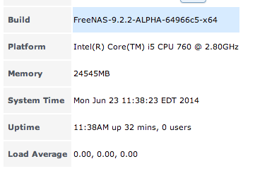

Hello all,
I seem to have a big issue on my hands. Before I get into detail,I attached my server information.
After every reboot, I get this error when trying to mount the local file system. I have 3 zfs pools. I took out all of my drives and the server booted up fine. I than put each pull back in the server one at a time until I hit the problem. I now know which pool is giving me problems, but I don't know how to get it back.
I think the problem occurred during a scrub. I have a scrub scheduled for the first sunday of each month for all my pools. What is odd is that I got an email stating that a scrub was started for this pool. I don't ever remember getting an email for scrubs and I never got one from the other scrubs.
This server and pool has been working without an issue for months. I haven't made any hardware or software changes in weeks.
I now have the server booted up without the pool that has the error. After the server booted up, I plugged in my disks. The server sees all the disks, but the status of that pool in unknown.
Thanks for any support you can provide. Let me know if you need more information.
-Chris

You're not using ECC RAM (core I5 doesn't support it).
What you describe looks like your pool has been eaten by defective RAM.

The cpu is at least 3 years old so I doubt it is one of those newer I5s... I will run a memtest.

1. Registered memory means nothing except you can do higher density. I can guarantee you that you aren't using registered memory with an i5. if you are that is a major problem as i5s do not support registered memory. Registered RAM has no bearing on it's ability to store data properly or error correction.
2. ECC is important. The fact that you aren't using ECC may or may not be your problem. The whole problem with the cosmic ray bitflip thing is that *if* it is because of that you have no way of proving it... ever.
3. No i5 that has ever existed has supported ECC RAM (at least AFAIK). So you definitely are NOT utilizing ECC regardless of your RAM type. To actually use ECC features with Intel hardware the motherboard *must* have a server chipset (this is the main reason we recommend server-grade stuff). Server-grade motherboards also have a unique socket that is not compatible with i5s. It's a game Intel plays with you. If you want ECC your options are to go low end- some celerons, pentiums, and i3s or go high end with a Xeon. Notice I didn't mention i5 or i7.
